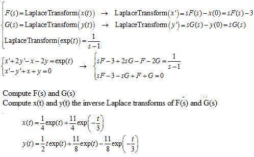

Hi !
An quick help to begin :

Of course, I know all that.
But the question was to solve the problem WITH THE LAPLACE MEHOD, not with the method that you propose.
I suppose the aim is to learn how to use the Laplace transforms, not to use the usual sustitution method or the matricial method, even if they are simpler.
So, I only show how to start and what it is expected to find at the end, for verification.
Yes, it is specifically asking to use the Laplace Transform, not algebraic systems. By using the Laplace Transform you do get an algebraic system though. At first I did make the mistake of looking at it in terms of algebra, but the answer looked very wrong. Not that bad of an idea though..just not Laplace.
And JJacquelin, did you use partial fractions? Thank you for the assistance!

I think that you made a mistake somewhere. You are on the good track.
Compare your two equations to mine. The notations are :
F(s)=X(s) and G(s)=Y(s)
How did you know there was a mistake? And yup, our equations are the same.
I don't know where is the mistake, but I got not the same Y(s) :
X(s) = (9s-8)/((s-1)(3s+1))
Y(s) = (7s-5)/((s-1)²(3s+1))
Okay..yes. The problem is that with my Y(s), there is a (s+1) and (s-1) in the denominator, but you have (s-1)^2. So I'm not sure how to get two (s-1)'s in the bottom of Y(s) because:
