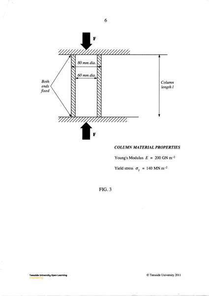

i am struggling with a question i have.. i can't find the right equation to use to find what the minimum length of the column at which buckling is likely to occur??
can anyone offer any help with this as my lesson books show me nothing on how you find length?
i have D=80mm d=60mm
youngs modulus 200GNm-2
yield stress 140MNm-2
The minimum length at which the column will buckle depends on the applied axial compressive load which is not given...

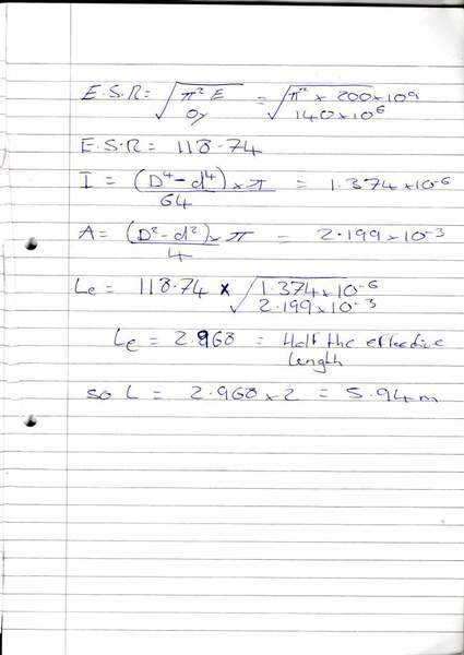

well at present i am trying to find the length so been looking at using these...
to find I... I = (D^4-d^4)*pi / 64
and for area,,,, A = (D^2-d^2)*pi / 4
E.S.R = (sq) (pi^2*E)/oc(critical stress)
and then
L = E.S.R * (sq) I/A
am i going down the right route with these as someone has told me the answer for length 5.94 but i need to find it my self as i can't just put that lol

my question i have says... what is the minimum length of the column at which buckling is likely to occur ... and the values i have put down are all i have on the sheet..
then i have what will mode of failure be and at what load..
i have included an image of my workings out so far for length,, which i have seen on the internet that 5.94 is the length just needed to find it myself... could anyone confirm this?

I painstakingly did the math and i get about 6 meters length when the column buckles at yield stress [itex]\sigma_{cr} = \sigma_y[/itex] , hope the math is Ok but in any event the problem statement is poorly worded.
That all pans out. I get the same.

ESR, a dimensionless number, stands for Effective Slenderness Ratio, and is equal to kL/r, where L is the length of the column, r is its radius of gyration, and k is a function of the end boundary conditions (k = 0.5 for a fixed-fixed column). The radius of gyration, r, is sq rt of (I/A).
For this problem, not clearly worded, in calculating the minimum length for buckling, the problem is looking for the max length before buckling occurs prior to the material reaching its yield stress. Thus critical buckling stress is set equal to yield stress. So the critical compressive buckling load to use is (yield stress*crossection area).
When dealing with buckling stresses, it is sometimes preferred to re-write the critical buckling stress formula , PI^2EI/(A(kL)^2) , as PI^2E/(kL/r)^2, or PI^2E/(ESR)^2, although more often than not it can sometimes confuse the issues.
