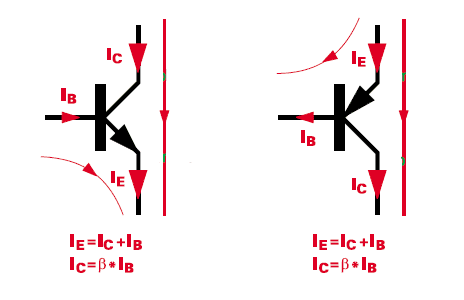

The formulas in question are:
Beta = Ic/Ib
Ie = Ib ( 1 + beta )
Ie = Ib + Ic
Yes, of course. Though the polarity is reversed. The terminals are named such that those equations are obeyed for both pnp and npn transistors.
Ahh...got it, so really the only difference is that +Vbe in NPN becomes +Veb in PNP
Thanks
You could ask yourself why the equations shouldn't apply. If you can't come up with a good reason then they would apply.
This diagram show everything
Thanks for the validation :)
