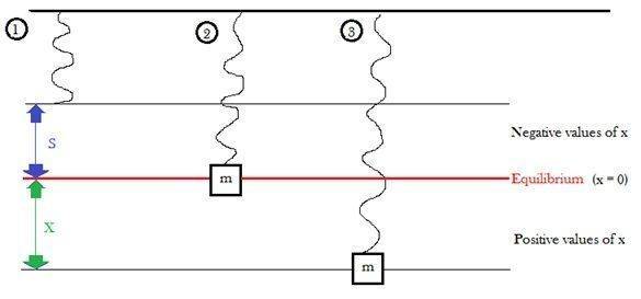

What do "s" and "x" mean here? In the first two equations, they are essentially the same. Do you mean that s is the "natural length" of the spring?
Start with any spring attached to the ceiling of room. Attach a mass to this spring. The spring will stretch downward due to the mass attached to it. Eventually the mass, attached to the spring, will reach an equilibrium point. At this point, there are two forces acting on the mass: The force of gravity puling the mas down, and the force of the spring puling the mass up.
For this problem, we assume that the downward direction is positive, while the upward direction is negative.
Downward force: F=mg
Upward force: Using Hooke's Law: the spring itself exerts a restoring force, F, opposite to the direction of the elongation, s. S is the distance the spring stretched (the length of the spring after attaching the mass - the length of the spring before attaching the mass).
*See figures 1 and 2 of my attachment.
Simply stated: F=ks, where k is a constant of proportionality.
At equilibrium, the two opposing forces are equal.
mg=ks --> mg-ks=0
Then, we use our hands to pull the mass down, past it's equilibrium point.
The two forces acting on the object are now:
Downward: F=mg
Upward: F=k(s+x) = ks+kx
If the two forces are equal:
mg = ks + kx
mg - ks - kx = 0 In this system, we know that mg-ks=0, so
0 - kx = 0

Oops, That's wrong but I figured it out.
The total force acting on the mass, when it's stretched down past equilibrium, is:
F = mg - k(s+x)
The upward force "-k(s+x)" is negative and the downward force "mg" is positive because we assumed upward direction was negative and downward direction was positive. Simplifying:
F = mg - ks - kx Again, in this system we know that mg-ks=0, so
F= -kx The total force acting on the mass at a distance x from the
equilibrium.
Once we let go of the mass, the spring will bounce up and down, or oscillate. Force in motion is characterized by F=ma
ma = -kx Acceleration can be expressed as the 2nd derivative of x with respect
to time
mx'' = -kx
mx'' + kx = 0
