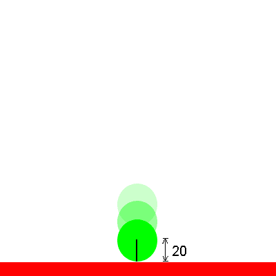

Here's an example of the situation I'm working with.
The distance vector for point of intersection would be (0, -20) in this case for the ball.
I assume the ball as the 1st object and the ground as the second object. I'm also considering the mass of the ground to be infinite and mass of the ball to be 1 and its moment of inertia as 400.

The ground has a horizontal surface in the x-direction and you have a two-dimensional problem? In this case, the orthogonal vector goes in the y-direction. It is simply (0,1).
I did use that. Suppose i have,
[itex]V_{i}[/itex] = (20, -10),
[itex]Vp_{i}[/itex] = (20, -10),
[itex]ω_{i}[/itex] = 0,
n = (0, 1),
[itex]M_{a}[/itex] = 1,
[itex]I_{a}[/itex] = 400,
[itex]r_{a}[/itex] = (0, -20),
I get the [itex]V_{f}[/itex] as (20, -30).

I think you have a sign error for j. Using your sign convention, it should be negative.
You mean [itex]V_{f}[/itex] = [itex]V_{i}[/itex] - [itex]\frac{-j}{M}[/itex] * n ?
But we are taking into consideration the normal of the impulse so how is that?
In the wikipedia diagram, the normal vector points away from object 1. This leads to the minus sign in the web page equation. You should have Vf = Vi + (positive factor)n.

|r x n| = 20, agreed? This gives me j = (2*30)/(1/1+400/200) = 20.
Sorry for the late reply. I just identified an error in my application of the equation. I was taking the square AFTER dividing (r x n) by I in the denominator.
I'll have to see how this turns out in my application. Will do some tests.
