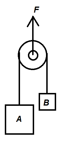

1. The problem statement, all variables and given/known data
(Sorry if I used any wrong term, English isn't my first language)
Be A (mass M) and B (mass m) two blocks connected to each other through an ideal wire passing through a wheel (caster), each block stays at one of the side of the wheel. If we apply a force F pointing up into the center of the wheel, which will be the acceleration of the wheel in terms of M, n, g and F? (Neglect the air resistance and the frictions).
Please, see the diagram:
2. Relevant equations
3. The attempt at a solution
It is wrong, I know, but I don't know why!
Be M > m
We have
Mg - T = M.a
T - mg = m.a
Thus, T = 2Mmg/(M+m)
So, the acceleration γ of the wheel should be F - 2T = (M+m).γ
γ = (F - 4Mmg)/(M+m)^2
Which is wrong...

Hi, Tiba. Welcome to PhysicsForums.
Does the wheel have a mass?
Note that in this problem the two blocks will not have the same magnitude of acceleration, so you don't want to use the same symbol "a" stand for both blocks.
Aug2-12, 07:35 PM   #4
Recognitions:
Gold Membership Gold Member
Homework Helper Homework Help
Two Blocks and a Wheel
Also, note that F - 2T is the net force on the wheel. So, what mass should you be using in the equation F - 2T = mass * acceleration?
[EDIT: If the wheel has a mass, then the net force on the wheel would not be F - 2T since you would have to include the weight of the wheel.]
[EDIT 2: They must be assuming a massless wheel. Otherwise, you would need to know the moment of inertia of the wheel, which is not mentioned. (Moreover, with a massive wheel the tension would not be the same on each side.)]

Hello,
Thank you for your answers, but I'm still a little confused.
Just to clear out the things:
I) The Wheel is massless.
II) M=2,0kg, m=1,0kg, F=30,0N.
III) The correct answer given in the textbook is γ=1,250m/sē
Can someone please show me the calculation for this?
Also, this isn't the case where the blocks have an apparent weight [being Pa=m(γ+g)] rather than mg?
Thank you!

Quote by Tiba View Post
Mg - T = M.a
T - mg = m.a
I would recommend that for this problem you take upward as the positive direction for all forces and accelerations.
How would you then write the above two formulas? Keep in mind that the accelerations of M and m will not have the same magnitudes, so you'll need to let a1, say, be the acceleration of M and a2 the acceleration of m.
F - 2T is the net force on the wheel. So, you have the wrong mass on the right side of the equation.
Note that you have four unknowns, a1, a2, T, and γ. Once you fix up the above equations you will have 3 equations for these four unknowns. So, you'll need a fourth equation. You can construct a fourth equation from the constraint that the two masses are connected by a string of fixed length.
Aug3-12, 08:56 PM   #10
Thanks, TSny, I think I got it!
Let:
M = 2, m = 1, F = 30, g = 10.
T - M.g = 2,0a
T - m.g = 1,0b
F = 2T
Then
a = -2,50
b = 5,0
Finally:
γ=(a+b)/2
γ=1,25m/sē

That looks very good. ....Just wondering, how did you justify the relation γ = (a+b)/2?
Aug3-12, 09:21 PM   #12
In relation to the acceleration of the wheel, a = -b.
So, to an outside observer, a - γ = - (b - γ)
Giving γ=(a+b)/2
Right? :)
Aug3-12, 10:49 PM   #13
Recognitions:
Yes. Very nice.
