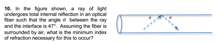

In the attachment below, a ray of light undergoes total internal reflection in an optical fiber such that the angle θ between the ray and the interface is 47°. Assuming the fiber is surrounded by air, what is the minimum index of refraction necessary for this to occur?
Snell's Law:
[tex]n_1 sin(\theta_1) = n_2 sin(\theta_2)[/tex]
Assume the index of refraction for air is n = 1.
Total internal refraction occurs when the light ray is incident to the air at an angle greater than the critical angle, θc. At the critical angle, the refracted light makes a right angle. So . . .
[tex] n_1 sin(\theta_c) = n_2 sin(90 \circ) = n_2[/tex]
[tex]n_1 = n_2 \div sin(\theta_c) = 1 \div sin(47 \circ) = 1.37[/tex]
But the correct answer is supposed to be 1.47. Why is that?

Hint: θ is not the angle of incidence.
