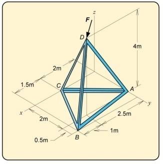

Determine the magnitude of the moment of the force F about the axis CA of the tripod
ABCD, if F = {40i -30j -100k}N.
Image attached.
2. The attempt at a solution
Based on a similar question I found in the textbook my method to solve this question:
Find UCA = rCA/rCA = (-2/√8)i + (2/√8)j
Find MCA = UCA.(rDC?? * F)
However, I am unsure if the finding the position vector rDC is correct?
Am I going about this the right way?
Please help.
Thanks,
Tim

Here's your image:
First of all your rCA must be incorrect. Look closely. Point A is 1.5 m from the origin on the y-axis. Point C is 2 M from the origin on the x-axis.
