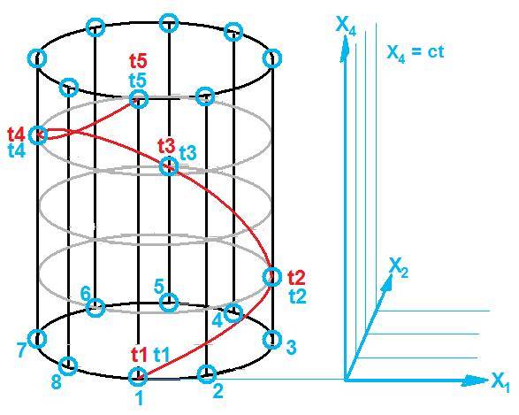

bobc2 said:
E always observes that R's clock is always running slower? Rethink that.
Good catch. You were right to question that.
Here's a link to my previous posting that gives the solution to this problem of circular motion, when the inertial person is located at some fixed position on the circle:
https://www.physicsforums.com/showpost.php?p=4040633&postcount=286
The age-correspondence graph shown is for the case where the traveler is moving very fast (v = 0.866c), so that gamma = 2.0. For that speed, from the traveler's "perspective", the inertial person is never aging slower than the traveler. The inertial person concludes that he is always aging exactly twice as fast as the traveler. The traveler concludes that the inertial person is sometimes aging somewhat LESS than twice as fast she herself is (but always at least a little faster), and that sometimes the inertial person is aging somewhat MORE than twice as fast.
In the case where the traveler's speed is very slow compared to light speed (like in the rotational speed of the earth), gamma is only very slightly greater than 1.0, and there are some segments of the circular motion where the traveler will conclude that the inertial person is aging (very slightly) more slowly than she is, and other segments where the traveler will conclude that the inertial person is aging (very slightly) faster than she is.
Good job, GrammawSally (are you actually a grandmother?). That's exactly the analysis I had in mind. PeterDonis always seems to be well informed on special relativity, so I thought he just wasn't thinking carefully and would recognize the error in his statement right away and follow up with a correction.
But your reference was right on the money and shows quite clearly what is going on. Thanks a lot for jumping in. I think joshcad55 will appreciate this.
