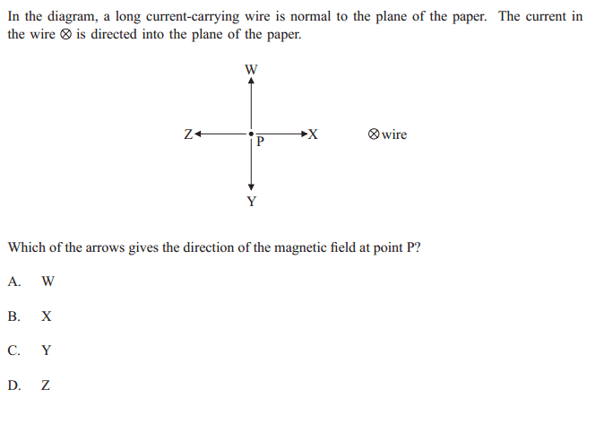

In the picture.
Right/left hand rule?
I have tried applying the right hand rule to this situation, but they only give me the current and nothing else, so i can't determine the direction of the magnetic field in the point P.

Yes, you can determine the direction of the field at P. Can you describe what the magnetic field lines look like around a straight wire that's carrying current? Can you explain the "right hand rule"?

You can use that "thumb-rule" with the right hand? As the current is going into the paper, the magnetic field would be in a clock-wise direction. On the other hand, the lines would be circles in which the magnetic field is in a clock-wise direction.
The "right hand rule" is used because the magnetic force is always normal to the magnetic field?
Right, the magnetic field lines will circle around the wire in a clockwise direction. Knowing that, can you see what direction the field will be at point P?
So i just sort of "expand" the magnetic field lines until it reaches the point P? And the direction would be upwards if i draw a "tangent" to the magnetic field (which is in a curve) at that point.
Correct! The magnetic field vector at a point is tangent to the magnetic field line that passes through the point.
