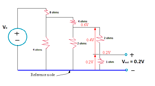

Use voltage and current division to determine [itex]V_{0}[/itex] in the circuit given that [itex]V_{out}[/itex] = 0.2V.

I started out by combining the 1 and 2 ohm resistors to make a 2/3 resistor. Then I combined that with the 2 ohm resistor in parallel to make a 1/2 ohm resistor. I combined that with the 4 ohm resistor in series to make a 4.5 ohm resistor and then combined that result with the 4 ohm resistor in parallel to make a 8.5 ohm resistor. Finally I combined the 8 ohm resistor in series to get 16.5 ohms.I guess I added wrong in my previous answer.16.5 = [itex]R_{eq}[/itex]
0.2 = [itex]\frac{1}{16.5}[/itex] * [itex]v_{s}[/itex]
3.3 = [itex]v_{s}[/itex]
I just did what I read in my book. I found the equivalent resistance so I could find the proportionate fraction of the voltage for the 1 ohm resistor. So since 0.2v is given I solved for Vs

Ah. Unfortunately that technique will not work here. You might determine the net resistance in order to calculate the load on Vo (the diagram designates the source voltages as Vo), perhaps to determine the current it supplies as I = Vo/Req, but it won't allow you to find Vo given Vout.
I can see several possible approaches, two of which are as follows.
1. Reduce the network behind the 1 Ohm resistor to a single resistor and voltage supply. That is, find the Thevenin equivalent of the network up to but not including the 1 Ohm resistor, leaving the Vo as an unknown. Then apply the voltage divider formula to the resulting simplified circuit to extract a value for Vo. Reduction of the circuit can be accomplished stepwise by working from left to right, forming successive Thevenin models as you go.
2. Starting at the output, note that with Vout specified you can find the current in the 1 Ohm resistor. Where does that current come from? It must come from the 2 Ohm resistor. So what's the voltage drop across that resistor? What then is the potential at the next junction (where the 4 Ohm resistor meets the two 2 Ohm resistors)? Continue to work back in a similar manner until you reach Vo.

The 2ohm resistor has a current of 0.2A so it's Voltage is 0.4V. At the node where the 4 ohm and two 2 ohm resistors meet is what confuses me.
If I use KCL, then I1+I2 = 0.2A. So how can I solve for the two unknown currents?

That's just the potential increase as you cross over the 2Ω resistor.
You want the potential with respect to the common rail that runs along the bottom (it's a convenient reference point for potentials for this circuit).
I'm still confused, am I supposed to add the voltages of the 8 ohm resistor 4 ohm resistor to find the voltage at that node?
No, you do a KVL "walk" from the bottom of the 1Ω resistor, through the 2Ω resistor to the node. You're building on the values that you're calculating along the way...
is this correct?
-0.2V + 0.4V +2I = 0
i = -0.2
You just want to "walk" from the reference node to the node in question, adding up the potential changes along the way:
Does this mean the potential across the 2 ohm resistor is 0.6 volts?
It does indeed! So now you can work out what current it must be flowing through it. And you already know what current flows out through the other 2Ω resistor... a little KCL at the node should then tell you the current through the 4Ω resistor... carry on.
Excellent. That looks fine :smile:
