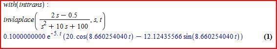

Pretty simple for some of you I know, but I have a laplace transform equation from a basic series RLC circuit
((sV-v(0))/L+si(0))/(s^2+sR/L+1/LC) = I(s)
I want to take the inverse laplace of it, I am given all initial conditions, and constants for R,L, and C.
I've done laplace but cannot figure out how to take the inverse of this one, and cannot figure how to check it with maple..
Any help appreciated.
EDIT: initial conditions are L = 10H, v = 10v C = 1000uF i(0) = 1A R = 100ohms
Can I just fill in values at this point and attain 2s-.5/s^2+10s+100 and simplify this and bring it back to the time domain?
Sorry, I am asked for the current response in the time domain.. So I think this is the right approach... maybe I have made a mistake.
Any help with the maple would still be appreciated greatly. I am new to the program.
I get 2e^-5tcos(sqrt75)t - (21/2(sqrt75))e^-5tsin(sqrt75)t
I was expecting a cleaner result...

I actually also got it figured out in maple, and received the correct answer by hand. The one up there is not correct, but it is close.
The correct solution is -4.5/sqrt75sinsqrt75t + cossqrt75t

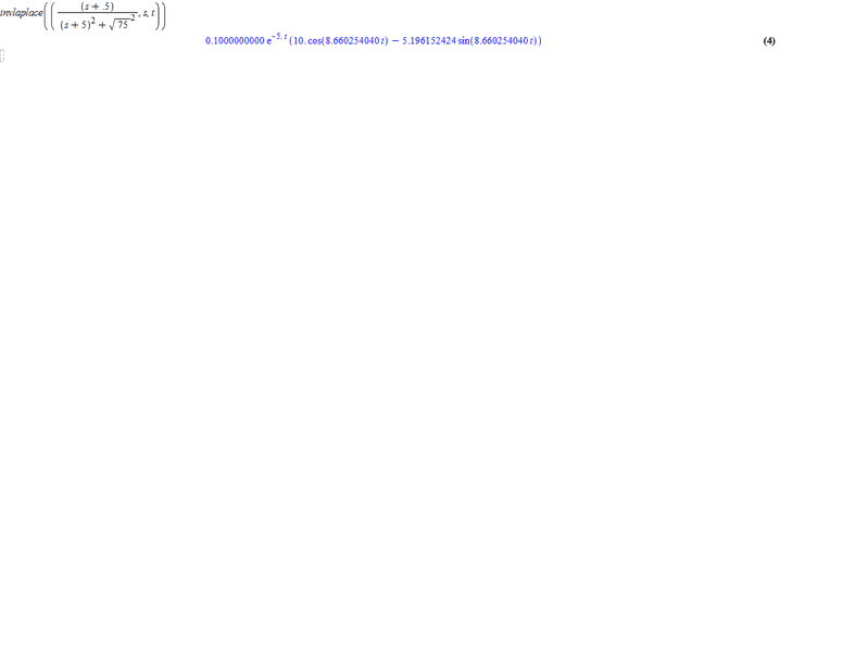

What is V? What is v(o)? In sV-v(0))/L, does L divide the numerator, or is it sV-v(0))/(L+si(0)))? The solution to the LaPlace expression by uart is in the attachment. Did you read the help file for MAPLE?

Actually I simplified it wrong friend
but I have it figured out now in terms of manual calculation. Thankyou for the attachment, I now understand how to put it into maple.
the correct solution was
L = 10H v = 10v C = 1000uF i(0) = 1A R = 100ohm
v(t) = Ri(t) + Ldi/dt + 1/cintegrali(t)dt
taking the laplace and simplifying I got I(s) = V(s)/L + Si(s) - v(0)/L all over SR/L + S^2 + 1/LC) which when I inverse laplaced, I got i(t) = -4.5/sqrt75sinsqrt75t + cossqrt75t which is correct

Here's what I put into maple I did not know about with(inttrans) Thanks, helped
