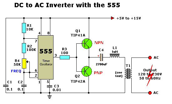

How does a power inverter change DC into AC like do they use transistor or capacitors as I never seen the inside of one and wanted to know what components are used?

but to get back to basics and answer your question :)
here is one very simple DC-AC inverter, couldn't get much simpler...
here is a slightly more complex one with more current handling...
3 basic parts to the inverter
An oscillator, Switching transistors, Transformer
The oscillator switches the DC voltage throuogh the transistors and the low voltage primary side of the transformer, producing either a square wave or sine wave. That induces a voltage into the hi voltage secondary windings of the coil.
Many inverters are a square wave type and for much equipment , that's OK, the down side is that square waves oscillations have many harmonics
but with some extra electronics you can produce a much cleaner sinewave in the transformer and that's better for equip that relies on a purer sinewave AC voltage
