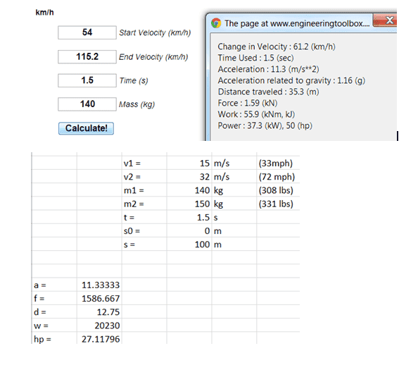

Hi Simon,
On the first website, my acceleration value and force values match, but the distance value is off by a magnitude of roughly three. When following their standard formula, my distance value is replicated. Why their's is different, I do not know.
The second website does not demonstrate all the formulas. Since there is no indication of calculating forces and distances, there is more "math" going on in the background that they have not documented. I would like to mimic their calculations so that I can fine tune it to my application.
The sites are merely for example of what I am trying to solve. Ultimately I am inputting formula's into a large spreadsheet to plot graphs for comparison.
It is assumed to be constant acceleration. The accelerating force is a small ICE, hence the use of HP. As most would know, to get to watts from hp, we just multiply by 746.
Thanks!
newman180 said:
Hi Simon,
The first website has a calculator where you input speeds in kmph and time in seconds ... if I test it out with initial speed = 0, final speed = 3.6kmph (=1m/s) I get 1m/s/s as expected.
If you didn't convert the units, you would be out by a factor of 3.6.
Since you have the same equations, you can write the program.

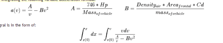

The second site provides all their equations at the top. They are taking into account quite a few more variables than the first one, like drag.
You don't want the second one then - they are using variable acceleration formulae. You should be fine with normal kinematics.
This is the output prompt and my excel sheet. You can see that the distance is the factor which is off.
You don't want the second one then - they are using variable acceleration formulae. You should be fine with normal kinematics...
Very true, but at the bottom of the calculations it gives me the information I'm looking for. Time it took to accelerate from 15-32 with 25 hp and 140 kg. As a bonus it told me how far a distance it traveled.
I would like to replicate this similar calculation if you wouldn't mind helping me, please.
Where is the distance in the calculation? Where does little "a" apply?

You want to know the distance traveled and time taken for a particular delta-vee at fixed power.
I don't think you can assume constant acceleration ... for fixed P and a, v=P/(ma)=constant; which would be a contradiction. You could insist on a constant acceleration restricted by maximum power available?
Going with the constant power throughout the motion:
Time taken: ##T=P/\Delta K##
$$T=\frac{2P}{m( v_f^2-v_i^2 )}$$ ... displacement is the area under the v-t graph:$$d=\int_0^T v(t)dt$$ $$P=\frac{dE}{dt} = v\frac{dv}{dt} \Rightarrow v(t)=\sqrt{2Pt}$$... assumes adding energy at a constant rate.
That should get you started.
