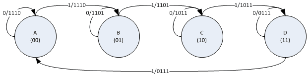

I am working on a 16:4 MUX that is comprised of four cascaded 4:1 MUXs. Each MUX has an active-low enable pin. To enable one MUX at a time, I need to use a counter that outputs the following:
Clock Cycle 1: 1110
Clock Cycle 2: 1101
Clock Cycle 3: 1011
Clock Cycle 4: 0111
In decimal, the clock is counting from 14 to 13 to 11 to 7 and then repeating.
I've generated a state diagram, a next-state table, a J-K FF transition table, the appropriate K-maps based on these tables, and finally a set of minimized SOP expressions from the K-maps. However, my output pins (Q0, Q1, Q2, and Q3) are all high all the time. I don't understand why.
My tables, K-Maps and SOP expressions are here: http://goo.gl/R0Ij7

Ok, approaching this as a state-machine with two flip-flops, I created the state diagram above.
The input will be a square wave (01010101010101...). Every time there is a 1, the machine progresses to the next state A to B, B to C, D back to A. When there is a zero, the current state is held.
Does this sound closer to the right idea? I will work on a state table and excitation table and see what I come up with.

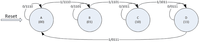

Yes, that looks good. To follow convention, you should also show a Reset arrow into whatever you want your first state to be. Real-world state machines always have to have a Reset state defined.
Would the D state count as a reset state since it puts the machine back to the initial state A?
So would this be the convention:
Your reset arrow looks correct, if you want to start in State A. The D state does not count as a "reset state" -- Your A state is the "reset state", since that's the state you go to when you assert the Reset input on your FFs.

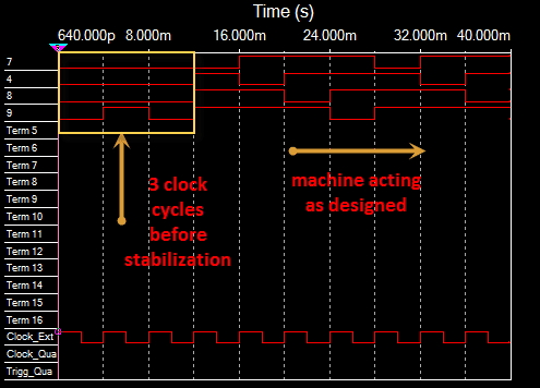

I was able to use a 555 timer (used as a one-shot) along with a manual enable switch to get the FSM started. I know I have control over the pulse width of the one-shot per the equation tw=1.1R1C1. My current values for R and C have the pulse width pinned at 30 ns. Perhaps reducing the pulsewidth will fix my issue which is that the FSM doesn't stabilize until the fourth clock cycle.

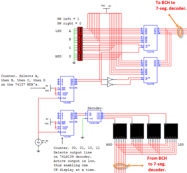

Hello again Berkeman and LCKurtz. I completely revamped my whole approach to this problem. Instead of using four MUX's, I'm using two 74157's to multiplex the four 4-bit binary-coded hex digits to the decoder.
I'm using a counter and a decoder to bring the common-cathode pin of one of the LCD displays low at a time. This enables only one display per clock cycle.
From what I can tell, my circuit is working well, except for one thing... The common-cathode displays have an "on current" of 5 mA but my current is in the pico-Amp range. I don't know why considering I'm using a 5 V dc source and 1 k-ohm resistors.
I think the current being way off is causing the crazy flickering in my seven-segment displays. I can see the numbers that should appear on the display, but there is a ton of random flickering which I think is a current issue.
Here is my circuit (minus the decoder which takes up too much space):
The circuit including the decoder (which is just a bunch of combinational logic) is here:
https://picasaweb.google.com/115298634539153983401/Homework#5798895588599576962
You'll have to hit the magnifying glass button to zoom in.

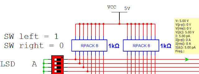

Perhaps I don't understand how your parts work, but it looks to me like if you put the switches in the "right" position, you are shorting the ##V_{cc}## to ground. Or do you have pull-up resistors coming down from the ##V_{cc}## bar you haven't shown?
Hi there,
I neglected to add pull-up resistors. Thank you for catching that mistake. I've added them now but my current is at 5 pA which is extremely low considering the displays need 25 mA.
