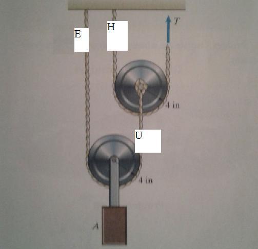

I have to solve this question in two ways, the first is from kinetics and kinematics and the second from the principle of work and energy. For the the first problem I obtained 3.160643122 for the acceleration at b(pulley with force t) and proceeded to find to find the velocity at a which I found out to be v = 1.256980509 by using v2=2ad
I then proceed to use the principle of work and energy but can never match the answers. I am not sure where I am going wrong.
The goal is to find the velocity at velocity at B(second pulley/pulley with force T)
Note the question changed a little with the force T moving upward 6 inches
Basically by using kinematics and Newton's Equations I came to the answer that the velocity of B the (second pulley with T force ) is 1.256980509 by using v2=2ad
Then I would have to use the principle of work and energy to find out the same velocity which should be the same as question 1

Your kinematic approach looks excellent, although I haven't cranked out the numbers or checked all your subscripts carefully. You've put in a lot of good work.
For the energy approach, looks like you slipped a minus sign, regarding the work done by gravity. And what happened to the M dθ term?

My teacher said that since no moment was applied it would be zero
The good news: our answers are somewhat close which in a problem like this is probably a good thing.
I got 1.77776 ft/s for vB (which means vA is .88888 ft/s=.5*vB)
Using work: The work from the tension adds energy which becomes PE, KE, and rotational KE.
Simple equation (I converted the 3 masses to slugs and used 32.2 ft/s for gravity and converted all lengths to feet. Note 6 inches=.5 feet. Sorry, I had to leave units out of calculations for speed. I also use parentheses for multiplication. I=.022 r=.3333):
work: 15*.5=Wtension=
PE: +10(.5).5 +10(.25).5 +20(.25).5
KE: +.5(mpulley)vB^2+.5(mpulley)(.5*vB)^2+.5*mass*(.5*vB)^2
RotKE: +.5(I)(vB/r)^2 +.5(I)(.5*vB/r)^2+0

It seems to me that the applied force F produces moment about the center of the top pulley.
Actually I'm going with his teacher (again) now. The ropes cause moments on both pulleys but that gets accounted for in the [itex]\frac{1}{2}[/itex]IbW2+[itex]\frac{1}{2}[/itex]IaW2 terms. The rotational positions of the pulleys don't have different energy levels so no Mdθ terms are needed in this case I feel. Quick analogy: if you push a block on a frictionless horizontal surface, all the work done goes into KE. Similar for the pulleys.
What do you think PhantomJay? Mdθ terms still needed?
Edit: I see. You can use the moment to calculate how much work is done on the pulleys. The problem is the moment is unknown because the ropes that go around the pulleys change tension some. Simpler to go from the work put into the whole system becomes PE, KE, and rotationalKE in this linked system. Mdθ will come up in different methods.

2FA-([itex]\frac{1}{2}[/itex])(ma+mc)gA-(mbgA)=[itex]\frac{1}{2}[/itex](ma+mc)2V2f+[itex]\frac{1}{2}[/itex]mbv2f+[itex]\frac{1}{2}[/itex]IbW2+[itex]\frac{1}{2}[/itex]IaW2
Is that how you did it ? I did it this way and got 1.265
At first even for my kinematics approach I got 1.777 when I used d=d but I thought it would move half of the rope therefore d= d/2 , which is how I got the 1.25 and I am getting 1.26 using the approach above.
Here is my other method:
The letters in the picture mean tensions.
k=mass pulley. l=mass of the hanging mass. AA=acceleration of A and hanging mass. AB=acceleration of B. Parentheses often used as multiplication.
I drew a free body diagram (of both pulleys) with linear inertial force and rotational inertia force. I used the picture to do the sum of y forces which equals 0. This gives two equations.
0=(-H-T)+U+(10+k*AB)
0=(-E-U)+(20+l*AA)+(10+k*AA)
Now (T-H)r=a torque=I(alphaB)=I(AB/r) which means H=-(I*AB/r^2-T)
and (U-E)r=I(AA/r) which means E=-(I*AA/r^2-U)
and AB=2*AA
Substitute
0=((I*2AA/r^2-T)-T)+U+(10+k*2*AA)
0=((I*AA/r^2-U)-U)+(20+l*AA)+(10+k*AA)
Using a some sort of solver
AA=3.16045 ft/s^2 and U=16.7852 lb
means AB=6.3209 ft/s^2
acceleration=AB
velocity=AB*t+0
position=.5*AB*t^2+0+0
position=.5*.5 which means t=.281252 sec
which means velocity=1.77777 ft/s which agrees as it should

You put a 2 before Vf which should be .5 and should be (.5*Vf)^2 not 2*Vf^2 and not (2*Vf)^2.
Yup the velocity should be 1.77, but I just can't seem to get it with the equation below
The W for the pulley from the bottom would be [itex]\frac{v}{2R}[/itex] and the other [itex]\frac{v}{R}[/itex]
2FA-([itex]\frac{1}{2}[/itex])(ma+mc)gA-(mbgA)=[itex]\frac{1}{2}[/itex](ma+mc)(0.5V)2f+[itex]\frac{1}{2}[/itex]mbv2f+[itex]\frac{1}{2}[/itex]IbW2+[itex]\frac{1}{2}[/itex]IaW2
Going off what was on the screen, I got it. Make sure to do (v/(2*r))^2 not (v/2r)^2. This formula looks good to me.

For the right hand side I got 0.397137375v2
for the left I got 7.5-6.250498975-2.499999995=-1.250498
used A=0.25ft, R=(1/3)ft ,I=0.0222
Good news. You're very very very close.
I could get -1.25 by switching the .5 to the third term (not that you did that). The number should be +1.25.
-6.2505 is miscalculated.
(Also I did get .39551 v^2 but my number and your number are close enough.)
