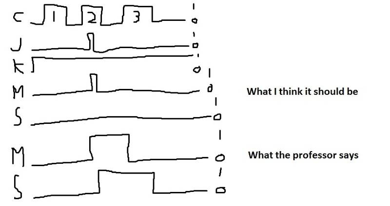

Just a picture of what we're dealing with.
I'm given a clock pulse, J and K inputs, and asked to describe the JK master-slave flip flop output.

I understand:
Clock = 1 -> Master value can be modified by changes to J and/or K
Clock = 0 -> Value of Slave is set to that of Master
Sorry for the drawing, I hope it is sufficient. During the positive clock phase I called 2, there is a brief blip in the J.
J & K are both 1, so I complement the Master value. it is now 1.
Now here is where I get uncertain. As I understand it, ANY change in J and/or K, even if there are 1000 changes, during a positive clock phase, will be reflected in the master. So only the FINAL value, once the clock drops from 1 to 0, in the master, "sticks".
So I say: that blip in J, well it drops quickly, during a positive clock phase, and so that leaves us with J = 0, K = 1, which is reset, so I drop the Master to 0 again.
However, this professor:
(skip to 4:10)
he's got an image from a book that says: "...something tricky about the master-slave, it's called the "one's catcher", it remembers any activity on the J or K while the clock is high. The J went high, then it went low, but it remembers".
It remembers? Can somebody explain how it remembers?
You have to take a look at the internal circuit, video at 1:30.
The SR for the master is *gated* by the constant output from the slave. If the slave has Q=1, setting J=1 on the master is ignored. Likewise if the slave has Q=0, setting K=1 on the master is ignored. In other words, if slave Q=1 you can only reset the master bit and if slave Q=0 you can only set the master bit with no way to take it back.
I suppose this turns into 'remembering ones', which may be a good mnemonic device once it's confirmed, but it doesn't teach anything :-/
Oh yeah. I see the Q and Q' values from the slave are wired back into the input gates of the master. That has some implications I have to take into account.
I agree with your statement on remembering ones. I can't accept that without understanding it, so thanks a lot for your help! Gonna take another look at this task tomorrow and make some adjustments. ;)
