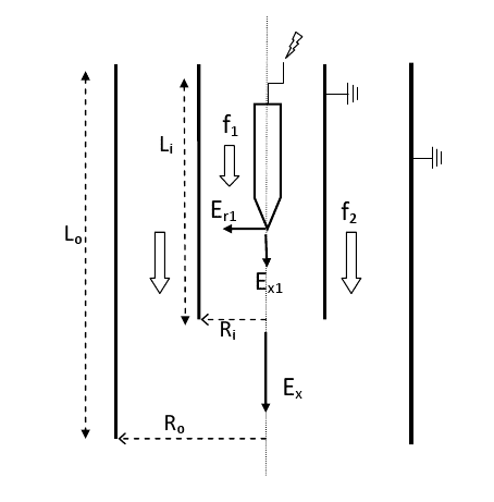

Hello, I have an experimental problem that I don´t know how to express theoretically.
It consists on a tip at high voltage inside an earthed cylinder, where a discharge is produced. The discharge is radial, since is the shortest distance to the wall, and produces ions, which are dragged out by an air flow f1, generating an electrical field in the axial direction Ex1 (fig. discharge.png).
There is an extra air flow f2 that joins f1 into a surrounding earthed cylinder, and then the field by the ions changes its value, Ex, since the flow is bigger and is further away from the discharge.
I have no clue neither how to calculate Ex1 nor Ex2. The attempt at a solution

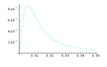

Therefore, the electrical field at the output of the inner cylinder would be:
[itex]E_{x1}=\frac{q}{4\pi \epsilon_0}\frac{L_i}{(L_i^2+R_i^2)^{3/2}}[/itex]
and therefore in the outer:
[itex]E_x=E_{x1}+\frac{q}{4\pi \epsilon_0}\frac{L_o}{(L_o^2+R_o^2)^{3/2}}[/itex]
obtaining the solution shown in Ex.png.
First of all, is a good approximation the rings to the solution?
and secondly, why the axial field does this increase in the curve? should´t it be constantly decreasing?

Second attempt:
I divide the problem in two parts, first inside the inner cylinder and then in the bigger one. I'll begin in the inner one where discharge is started
I suppose a radial discharge from the tip to the walls:
[itex]E_r=\frac{U}{r Log(R_i/R_{tip})}[/itex]
being [itex]U[/itex] the applied voltage and [itex]R_{tip}[/itex] the radius of the needle's tip.
The governing equations (all in cylindrical coordinates) are the Poisson equation for the field inside the inner cylinder:
[itex]\frac{1}{r}\frac{\partial (r E_r)}{\partial r}+\frac{\partial E_z}{\partial z}=\frac{\rho}{\epsilon_0}[/itex] (1)
and the convection-diffussion equation for the charge density:
[itex]\frac{\partial \rho}{\partial t}=D_i \nabla^2 \rho + \nabla \cdot (u \rho)=0[/itex] (2)
where [itex]D_i[/itex] is the diffusion coefficient and is so small that this term can be neglected. Velocities in axial and radial directions are:
[itex]u_r=Z_i E_r[/itex]
[itex]u_z=u_g+Z_i E_z[/itex]
with [itex]u_g[/itex] the [itex]f_1[/itex] flow velocity.
Therefore eq. (2):
[itex]\frac{1}{r}\frac{\partial (r Z_i E_r \rho)}{\partial r}+\frac{\partial ((u_g+ Z_i E_z) \rho))}{\partial z}=0[/itex] (2b)
Solving eq. (1) and (2b):
[itex]\frac{\partial E_z}{\partial z}=\frac{\rho}{\epsilon_0}[/itex] (3)
[itex]Z_i E_r \frac{\partial \rho}{\partial r}+(u_g+ Z_i E_z) \frac{\partial \rho}{\partial z} + \rho Z_i \frac{\partial E_z}{\partial z}=0[/itex] (4)
Substituting eq. (3) into eq.(4):
[itex]Z_i E_r \frac{\partial \rho}{\partial r}+(u_g+ Z_i E_z) \frac{\partial \rho}{\partial z} + \frac{\rho^2 Z_i}{\epsilon_0}=0[/itex] (4b)
Therefore I have a system of 2 equations (3 & 4b) with 2 unknowns ([itex]E_z[/itex] and [itex]\rho(z,r)[/itex]), but I'm totally stuck on how to solve it.
Please, correct me if my approach of the problem is not correct or there is any mistake in the resolution. I could use some software to solve the system of equations, but I'm not sure if they are resoluble.
Thanks in advance.
