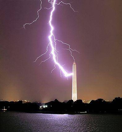

see this pic of the Washington Monument, by a fellow stormchaser, it gets struck a third of the way down its side
even tho there is a good leader traveling up from the tower top

When it comes to lightning protection, I understood that the sharp spike at the top of a 'lightning conductor' readily produces a corona, which forms a large radius conducting sphere, reducing the local field strength, making the building less likely to get a direct strike. I guess that would apply to a boat mast, too. I would need to lower my radio antenna, I suppose. Now which is more important to me - long range radio communication in the event of any emergency, of reducing the possible effect of a lightning strike? Decisions, decisions!
Again, back to the question of what is meant by "direct" and "indirect" strokes. Davenn conveniently posted a picture two posts back which may help answer my question.
Would the "direct stroke" be the thick bolt striking the side of the Washington monument and an "indirect stroke" be the thin bolt striking the top of the monument?

Regarding the thin and thick lightning bolts in the posted photo...I do not know how scientists qualify strikes versus leaders... It's possible, I think, that the thin bolt at the top of the building might be considered a leader and a major portion of the strike will follow it's path. This would seem to depend in part on the charge accumulation...if it is mostly dissipated at the moment of the photo, no such significant strike would likely follow.
davenn said:
… see this pic of the Washington Monument, by a fellow stormchaser, it gets struck a third of the way down its side

no, i think that's the difference between leader stroke and return stroke
a leader comes down from the cloud, splitting into several branches
another leader comes up from a building (etc), and may or may not connect to the downward leader
if it does connect, that connected path (from the cloud to the building) becomes the path of least resistance, and allows a huge return stroke, see http://en.wikipedia.org/wiki/Lightning#Leader_formation_and_the_return_stroke
Once a channel of ionized air is established between the cloud and ground this becomes a path of least resistance and allows for a much greater current to propagate from the Earth back up the leader into the cloud. This is the return stroke and it is the most luminous and noticeable part of the lightning discharge.​
so the very bright stroke in the above picture is the return stroke, and (look carefully! :wink:) the leader from the top of the building failed to connect to the downward leader (ie the lightning rod didn't work in this case :redface:)
here's another picture of a failed leader (the http://en.wikipedia.org/wiki/File:Lightning_hits_tree.jpg says "Lightning hits a tree. See the streamer on the left coming up from a pole. It is not connected to the main leading channel.") …
http://upload.wikimedia.org/wikipedia/commons/thumb/b/b1/Lightning_hits_tree.jpg/368px-Lightning_hits_tree.jpg
