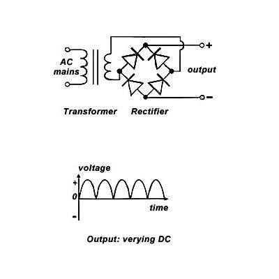

Also on Q12 ...
you DONT get smooth DC out of a bridge rectifier ;)
you don't even get smooth, flatlined DC out of a bridge rectifier with a smoothing capacitor ...
see the link you were given above for the ripple waveform
cheers
Dave
