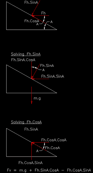

So I was having a discussion with a buddy and we were trying to decide the proper equation to translate a horizontal force to a vertical force on a wedge.
See my drawing below, if I apply a force at Fh, what is the equation for find out the force Fv?
Thanks!

I tried this. But not sure about the result...
