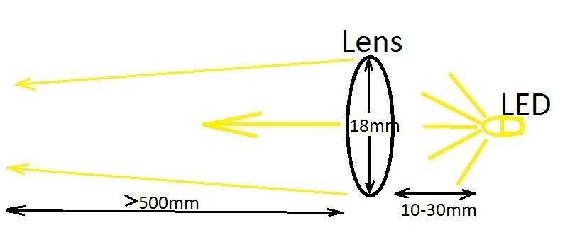

Hello.
I'm looking for a lens that can collimate (or focus far away >500mm ) a light coming out from a LED.
before I give more details is this even possible?
Thanks.

Take a pick, do you want it collimated or focused?
if the focused focal is far away it doesn't matter, I just looking for divergent/convergent angle smaller to 1 degree.
but if you want a pick let's said collimator.
A point source at the focal distance of a lens will produce a parallel beam out. So you want a 10-30mm focal length lens.
You need the thin lens equation.
