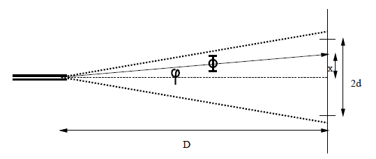

A rifle shooter aims at a target, at a distance d, but has an accuracy controlled by a probability density:
[itex]\rho(\phi)=\frac{1}{2\Phi}[/itex]
[itex]\phi\in(-\Phi,\Phi)[/itex]​
where [itex]\phi[/itex] is the angle achieved and is bounded by the small angle [itex]\Phi[/itex].
(Refer to attachment for diagram)
Calculate the probability density for where the bullet strikes the target, [itex]\tilde{p}(x)[/itex]. (I've done this.. I think)
If a target is set up with a width of 2d, with success H say, being hitting the target and failure M say, being missed the target, calculate and depict the probability of hitting,
[itex]P(H;\Phi)[/itex]
as a function of [itex]\Phi[/itex] for fixed d and D with [itex]D=tan(\theta)[/itex]
Hint: Be careful about when [itex]\Phi=\phi[/itex]

D is the distance from the shooter to the target. (shown in attached diagram)
I would integrate it over the interval I want the probability for ?
D = the distance to the target (you did that - good)
d = the radius of the target
x = radius to where a bullet went at the target distance - so that $$p(x,x+\delta x)=\frac{2\Phi\delta x}{\pi}$$... this is what you are telling me?

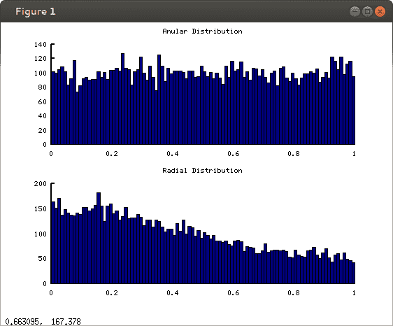

I think you need to get a better feel for how the statistics behave:
The image below shows a sample of 10000 shots from a flat angular distribution (top) the angle is in units of ##\Phi## and they have been grouped into lots of ##\Phi/100## so that there is an expectation of 100 shots in each histogram.
Below that is the same 100 shots according to where they hit the target. (Distance is in units of X.)
Notice how the distribution is not longer flat? Instead, you'd get bullet holes clustered closer together near the center and spreading out as you get further away.

it is $$\frac{D}{D^2+x^2}$$
but why do we need the derivative?
also, for small delta x, the expression is 0, isn't it?
(Edit:sorry for messing up the variables again, I typed small d's before)
oh I get it,
$$\int{p(x) dx} = \frac{1}{2\Phi} (arctan(\frac{x+\delta x}{D})-arctan(\frac{x}{D}))$$
if that is right, we would then differentiate it..
but what about the [itex]\delta x[/itex] ? How do we take care of that?
zeeshahmad said:
for $$arctan(\frac{x}{D})$$
Basic process of differentiation: f(x+δx) ≈ f(x)+f'(x)δx
Put ##f(x) = arctan(\frac{x}{D})## and see what happens.
i get
$$p(x)=\frac{1}{2\Phi}(\frac{D}{D^2+x^2})$$
