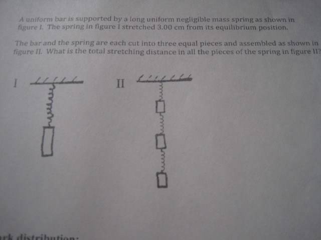

See image attachment
Fs = kx
Es = 1/2 kx^2
ET1 = ET2 which is Eg1 + Ek1 + Es1 + work applied = Eg2 + Ek2 + Es2 + friction
grade 12. Please help i never did anything like this.
This is a force/equilibrium problem, not an energy problem.
A hint to start you off: If you look at diagram I and imagine the spring cut into three pieces, how much does each piece stretch?
each piece will stretch 1 cm
Good. So now you know that the weight of the complete rod will stretch one of the spring pieces by 1 cm. How much will the weight of 1/3 of the rod stretch one of those spring pieces?
Use this reasoning to figure out how much each spring stretches in diagram II.
1/3 x 1cm = 1/3cm
is it 1/3cm + 2/3cm + 3/3cm = 2cm
firezap said:
1/3 x 1cm = 1/3cm
Good!
