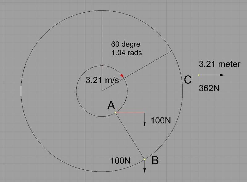

So here is a diagram explains the problem.
There is an arm in between A and B points.
This arm is attached to the smaller circle which rotates with 3.21 m/s. This rotation is due the force being applied at the end of the arm at B point.
Now let's start with the forces; The torque at point A would be arm length x force x sin (angle in between arm and force) . THe torque is 6.84m x 100N x sin(147.995
) = 362.5 NM
Basically at that point 362NM "rotates" with 3.21 m/s or with 1.04 rad. So the power would be P=T x ω by the physics but hej, this force - because torque is basically a force with a support arm - why would I use uu instead of velocity. And why ω would be different in this sense from the actual velocity? What is the reason for this? So why not use instead P = ω x r x T Can you explain this to me ?
Also this torque force could be just a liner move of force with velocity, must be same... (lets not consider the angle of the force or consider it always parallel to the arm)
So actually here it would be valid to say that power in other way would be: Power = Force x Distance / Time . This way the 362 N moves 1 meter in one second. So the power is 362Watts.
Well since I don't point exactly out where the force actually acting so I consider the arm as a One ARM lifter (dont know it in english) and consider the weight I have to lift and the rotation point on the other side at A point and the Force at B point. So just simply multiply with the length of the arm.
A point on the circumference of the smaller circle rotates at a tangential velocity of 3.21 m/s
are you using the correct arm length from the axis of rotation to point B. There are no dimensions so impossible to tell.
i think you mean 1.04 rad/sec, the angular velocity.
correct
why would I use uu instead of velocity. And why ω would be different in this sense from the actual velocity.
One reason is that it is easier to do calculations using ω. All points on a body rotating about an axis have the same angular velocity ω. The tangential velocity of points vary from a value 0 at the axis to a value v = r ω at the circumference.
For your problem, Point A and B have the same angular velocity ω ( rad/s ), but the tangentiial velocity v ( m/s ) of A is less than that of B.
Check the units and you will see that ωrT does not come out as watts, or power.

Perhaps you should think about it coming from the linear definition.
We define [itex]P=Fv[/itex], but in a rotational setting, [itex]v=r\omega[/itex] so we find that [itex]P=Fr\omega[/itex]. But now we notice that [itex]Fr=\tau[/itex] so we must have [itex]P=\tau\omega[/itex] and not [itex]P=\tau\omega r[/itex] as you said.
The reason for using torque and angular velocity is, as 256 says, it is often easier to use if you know that a system is rotating. It is significantly easier when you have a constant angular velocity. In this case, using the linear velocity is complicated since it is continuously changing.

You are wrong. There isn't much discussion about it. The force is the same whether or not there is an arm. The torque will be different depending on the length of the arm. If I apply a force of 1N to a lever, it is 1N no matter where I push. Depending on how far from the pivot I push, it will have a different torque, but the force is 1N. Torque is not force. We are not calling a force a torque for fun. We are calling torque a torque. Spend a little time thinking/reading about torque and then come back with questions.
