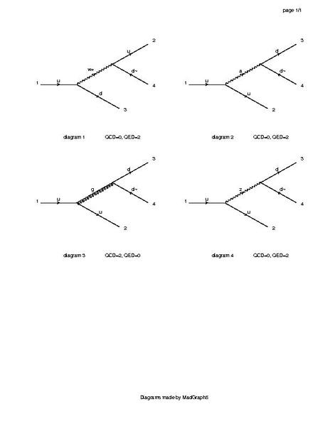

Hmm well I know that two quarks can annihilate to produce photons, but I guess I'm wondering about a more specific process here---where a single quark emits a photon, so that the original quark and the photon both go flying off, and then the photon decays into two quarks.
Yes, its possible. The photon can be considered a "long distance effect" while the strong a "short distance" effect. (all about energy scales).
Here are the first order diagrams for an up going to an up and a down-antidown pair:
[tex] \left(<br /> \begin{array}<br /> \text{WEAK} & \text{PHOTON}\\<br /> \text{GLUON} & \text{Z BOSON}<br /> \end{array}\right)[/tex]
Wow thanks!
