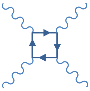

One also have photon-photon scattering (Delbrück scattering) and I think that in principle the photons can exchange energy. Maybe somebody from high-enegy physics can give us a definite answer.
The Feynman diagram for photon-photon scattering involves the photons being destroyed (they turn into particle-antiparticle pairs) and then getting recreated after a short interval. It's probably a philosophical point as to whether the exiting photons are the same photons as the incoming ones.
(recall - time is vertical axis and space is horizontal)
