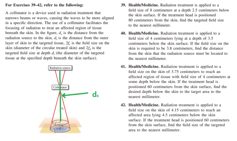

Posted #39 and $41. (look at the attachment).
ds = distance from the radiation source to the skin
dt = distance from the outer layer of the skin to the targeted issue
2fs = field size of the skin
2fd = targeted field size
None
None. Need to establish relationship between variables.
Please help.

Read the explanatory paragraph on the LHS of the attachment.
All of the necessary data is given. This is a problem dealing with similar triangles.

80^2 + 4^2 = h^2
(82.5)^2 + (fd)^2 = (h2)^2
6806.25/6400 = 1.06 (ratio of two sides)
4 x 1.06 = 4.25
But this is not right since the ds = distance from the radiation source to the skin
You have set the problem up wrong. You are not interested in finding the length of the hypotenuse of the triangle. You know the bases of two triangles and the height of the larger triangle. You are being asked to find the height of the smaller triangle.
How would you set up an expression to find the unknown height?

That's right for the triangles.
No, that's the ratio of squares of the lengths. We are not interested in squares of lengths, just the ratio of the lengths of corresponding sides of similar triangles.

Hmm. Thanks. So then 82.5/80 = 1.03125
1.03125 X 4 = 8.25 is the field size. But that is not right because d(s) is distance from the radiation source to the skin.

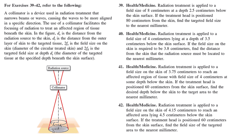

7.8 as the book say. I don't know. Maybe it is typo?
But look we used ds as one of the sides of triangle. But that ds is the entire height according what problem say. Also look I attached now again and marked it green line.

I see what you mean about ds but that is making it too complicated.
An answer of 7.8 would be the field on the skin if you take 8cm as the field of the targetted tissue (and lying 2.5cm below the surface).
What are the answers for the other parts?

For Problem #41 the answer is 4.0 cm. The book only have odd. Yes, it will make it complicated. I do not know how to solve that way then. :frown:
There is no ambiguity about #41. Can you show your working for it?
Also try #40 as I have worked out the answer.
