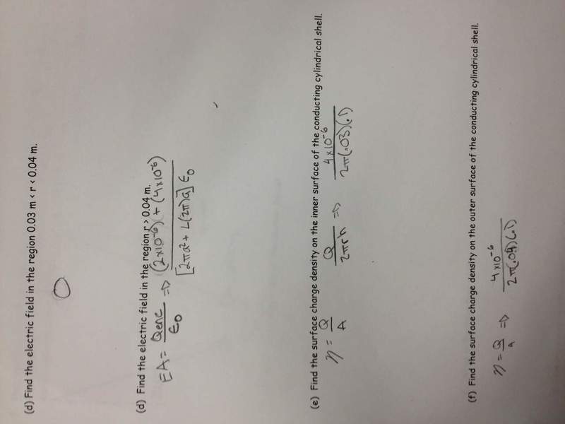

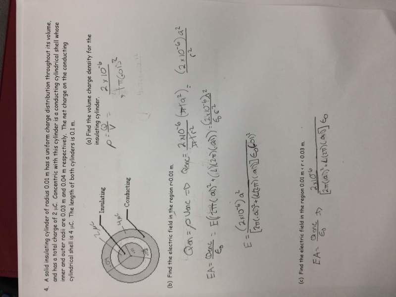

I'm not sure if I am doing part a,b,e, and f correctly
You'd get more responses if you were to post attachments that are the right way up! Even after rotation, the handwritten parts are pretty hard to read.
For a), the denominator is hard to read, but it looks like .1π(.01)2, which would be right.
For b), you seem to have used 'a' in place of the given variable r, and used r as the .01m radius. The cylinder length is ten times the radius, so I would think you are supposed to ignore end effects. If I ignore that term in the denominator and simplify what's left, it seems to give a value which increases with distance from the central cylinder, which cannot be right.
Pls take the trouble to post your working in LaTex, or write very clearly (no still-visible rubbings out!). It would also help if you were to define your variables.
How do you post the attachments that are up right away? Also, on my pc they do not need to be rotated for whatever reason when they uploaded it turned them sorry.
a) i have written .1 pi (.01)^2 in the denominator
