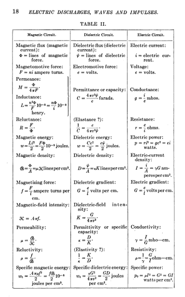

Yes there is, it's called the magnetic field. The magnetomotive force is F = ni ampere turns.
The magnetic field and its dynamics are directly related to current. Thus, if I assume the field decreases then there should be a corresponding decrease of current.
Source:
Elementary lectures on Electric Discharges, Waves, and Impulses and other Transients by Charles Proteus SteinmetzHere is a nice table from the book:

Magnetic fields can and do perform work on magnetic dipoles because the Lorentz magnetic force acts in the correct direction for work, along the velocity of the moving dipole. Mag force (Lorentz) does NO work on charge carriers since the orientation is normal to the velocity.
Menaus gave you the correct answer, there is a scalar potential associated with a mag field, called NI, or "magnetomotive force", mmf, measured in amp-turns. This mmf or potential is used when analyzing magnetic circuits such as transformers, motors, generators, solenoids, relays, etc. Any good energy conversion text should explain the development of the scalar magnetic potential aka "mmf".
