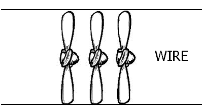

Consider the following experiment: from a lacquered copper wire we cut off twenty to thirty pieces of about 10 cm. From them we form a bundle of parallel wires and connect the two ends with one more wire each. The other ends of these two wires are connected to a sensitive analog ammeter. We hold the bundle horizontally and move quickly a strong and broad magnet downwards on its left side. The pointer of the instrument will make a deflection to one side. If we now move the magnet quickly downwards on the right side of the bundle, the instrument will make a deflection to the opposite side. The magnetic flux that we have produced in the wire is now in the opposite direction to the one in the first case, which is why the deflection is in the opposite direction. The motion of the magnet produces current even if we only approach it to the bundle from one side without lowering it below the bundle. In this case the current is somewhat weaker. But if we now move the magnet down to the middle of the bundle, the instrument won’t show any current, because the left and the right halve of the magnet act on opposite sides of the bundle, canceling each other out.
We can do the experiment with only a single wire instead of a bundle, as long as we have a very strong magnet and a very sensitive ammeter.
You can imagine that inside this wire there is a propeller or there are many propellers in a row. When you turn a propeller manually from the left side, then it is turning in one direction and it is blowing on one side (plus), but it is suctioning on the other side (minus). When you turn the propeller from the right side, then it is turning in the contrary direction and the air current is in the opposite direction. But you cannot turn the propeller from above. Exactly the same picture we have with the magnet and the wire.
After we have lowered the magnet down and have produced a current in one direction, then we can move it back upward. In that case we produce a current in the contrary direction, just as we will produce an air-current in the contrary direction if we turn the propeller from down up.

I try to find the principle and this comparison serves pretty good. In finding the principle I don't have to stick imperatively to a coil of wire.
Speaking of coils, here is a comparison for it: when we move a magnet in and out of a solenoid, we can compare that to the "push and spin" mechanisms, which can be found in small toy carousels, in some ashtrays or spinning top toys.

As far as I have understood your reply, you find two flaws in the analogy. The first is the speed of propagation of the action. You actually say that the air flow can't achieve the speed of the electricity flow.
Let's say we have a torus, a very long torus filled with air. Inside the torus there is fan, as big as the cross section of the torus. It begins to turn. Wouldn't all the air at every point inside the torus start to move instantaneously?
The second flaw I couldn't quite understand.
no, it movement propagates along the tube where as, as anorlunda pointed out, the EM field
propagates along the wire at near the speed of light taking into account the velocity factor of the wire
