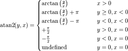

Where [itex]atan2[/itex] is defined as (from wikipedia):
