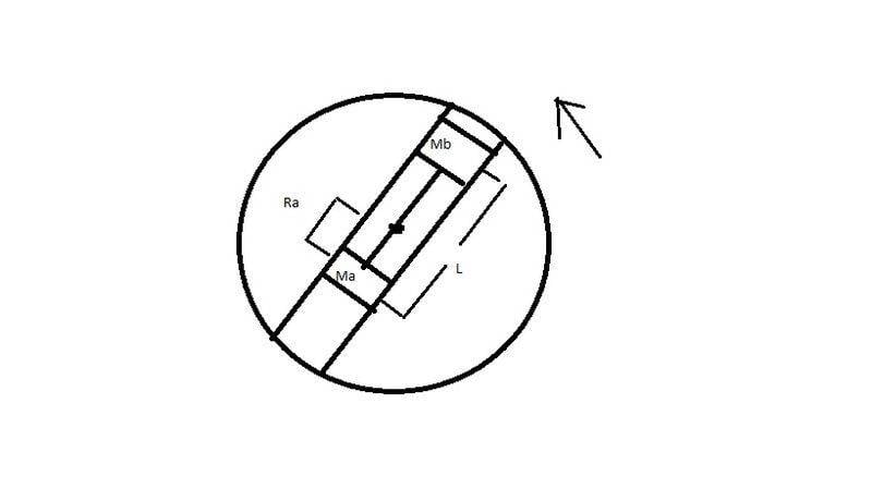

A disk rotates with angular velocity w. Two masses, Ma and Mb, slide without friction in a groove passing through the cnter of the disk. They are connected by a light string of length L, and are initially held in position by a catch, with mass Ma at distance Ra from the center. Neglect gravity. At t=0 the catch is removed and the masses are free to slide. Find r''_a immediately after the catch is removed in terms of Ma, Mb, L, Ra, and w.
a=(r''-rw^2)êr + (rθ''+2r'we) êθ
I figured that immediately after the catch is removed Ma only experiences a centripetal tension that must be equal to the one Mb is experiencing. So we'll have
Mb*r''_b=Ma*r''_a
Mb*r''_b=Mb*(w^2*Rb) = Mb*w^2*(L-Ra)
Ma*r''_a = Mb*w^2*(L-Ra) → r''_a= w^2*(L-Ra)*(Mb/Ma)
I would like to know if this is correct, or if I'm missing something (or everything!).
That sounds right.
So we'll have
Mb*r''_b=Ma*r''_a
What's the reasoning behind these two equations? I don't think they're correct.

Hi TSny! Thanks for your repply.
I've been thinking again, and saw that I was equating the centripetal acceleration of Mb to the radial acceleration of Ma.
Now I've reasoned that (centripetal force on of Mb)-(centripetal force on Ma) should result in the radial force on Ma. In this case
Mb(-Rb*w^2) - Ma(-Ra*w^2)= Ma*r''_a
Mb(-(L-Ra)*w^2) + Ma(Ra*w^2)= Ma*r''_a
Mb(Ra-L)w^2) + Ma(Ra*w^2) = Ma*r''_a
(w^2) [Mb(Ra-L)+Ma(Ra)] (1/Ma) = r''_a
the radial acceleration of Mb would be the same, but in opposite direction.
That sounds suspiciously like thinking in terms of centrifugal force.
I suggest it will keep things clearer if you introduce T as the tension and treat each mass separately.
Thanks, I thought a little bit more:
T=Ma*Aa; Aa= (r_a''-Ra*w^2)êr
T=Mb*Ab; Ab= (r_b''-Rb*w^2)êr
(I eliminated the êθ part of the vector, since it hasn't started yet to move -"immediately after the catch is removed"- therefore r'=0, and of course θ''=0).
Now, both centripetal accelerations point to the origin, therefore have the same sign, but, no matter how the whole system moves (whether Ma moves inwards or outwards), the radial accelerations will have opposite sign, and equal magnitud (since I assume also that the string is inextensible). Then r''_b= -r''_a
Equating the T's:
Mb(r''_b'-Rb*w^2)=Ma(r''_a-Ra*w^2)
Replacing r''_b=-r''_a', and Rb=(L-Ra):
Mb(-r''_a-(L-Ra)*w^2)=Ma(r''_a-Ra*w^2)
Mb(-r''_a+(Ra-L)*w^2)=Ma(r''_a-Ra*w^2)
Distributing Mb inside the left parenthesis, and then dividing all through Ma:
-r''_a(Mb/Ma)+(Mb/Ma)*(Ra-L)*w^2=(r''_a-Ra*w^2)
-r''_a(Mb/Ma)+(Mb/Ma)*(Ra-L)*w^2+Ra*w^2=r''_a
(Mb/Ma)*(Ra-L)*w^2)+Ra*w^2= r''_a + r''_a(Mb/Ma)
(Mb/Ma)*(Ra-L)*w^2)+Ra*w^2= r''_a(1+(Mb/Ma))
And finally
[(Mb/Ma)*(Ra-L)*w^2)+Ra*w^2] / (1+(Mb/Ma)= r''_a
I hope is clear (and ok)
Looks good!
Great! Thanks TSny, haruspex, for your help.
