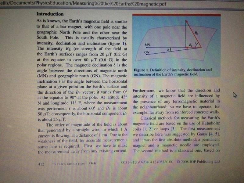

Sorry daven the magnetometer is bow provided to measure the Earth's magnetic field strength And I don't really understand the figure shown in 56785... I have learned about magnetic field but I couldn't understand much of the vocab because I'm my English level is not that good... I hope I have not offended u mate

Do you understand what vectors are, and how we represent the magnetic field?
I understand what vectors are but I do not how to represent in magnetic field I got a bit confuse at that point
Magnetic field is vector field, but is best represented as lines of force. At every point the magnetic field is tangential vector to the line et that point. You must check on the internet what those look like for the earth, it's easy to find. Then it shouldn't be difficult to visualise why is inclination in your book 0 degrees (parallel) at equator and why it is perpendicular to the pole. You should at that point have some ideas how to solve your problem.
xAxis, that's not 0 degree I think it represents something else but I just couldn't figure it out what it is
"It varies from 0 degrees at the equator to 90 degrees at the pole".
This is citation from your book. Have you checked the picture of the magnetic force field of the earth? Or of the bar magnet as they are similar?
I think the goal from the text is to have you build a current loop and introduce a known current into it. If you know the size of the loop, the number of turns, and how much current is running through it, you can determine it's magnetic field strength in the center. The idea then is to make a loop, place the compass in the middle, and apply a current so that the magnetic field in the loop just cancels the Earth's magnetic field.
xAxis that is why I don't understand... Maybe I will check with my classmate today I know the inclination and declination of my town now but I have no idea putting the vectors together. What I mean is that what do I have to find out first before looking for the value for Earth magnetic field
