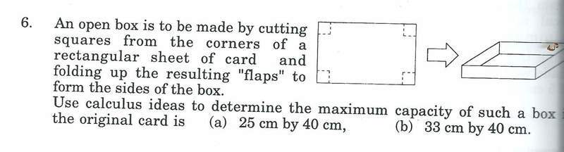

What is the optimal volume of a box with given dimensions using calculus?

SEE QUESTION IMAGE
SEE ABOVE

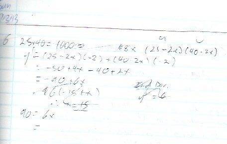

SEE WORKINGS IMAGE

Can you type in your work?
ehild
Sorry that my handwritiing is too messy and scan isn't done right. Just trying to get this done ASAP.
(25-2x)(40-2x)
y=(25-2x)(-2)+(40-2x)(-2)
=-50+4x-40+2x
=-90+6x
x=15
Not sure what to next do.

Is x the length of the corner pieces cut out? If so, you need to define it in words; a formulation without an explanation is worth 0.
Also, is (25-2x)*(40-2x) the thing you want to maximize? Why? What does the box look like if you use your proposed solution of x = 15?

You mean y', not y.
Also, I'm guessing that you want to maximize the volume. If so, then
y = (25-2x)(40-2x)
as the volume equation would be wrong. You're missing the height. What would it be?
