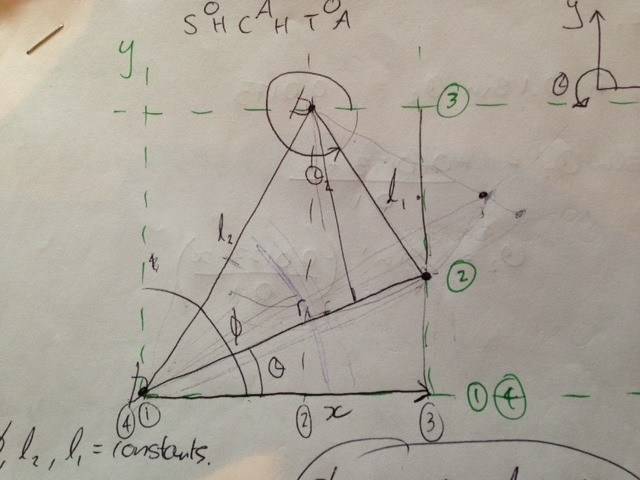

I am designing a near rear drive train for a formula student car which incorporates a chain tensioning device linking the differential to the rear of the chassis.
Essentially I am wanting to quantity the amount of movement in the x direction brought about through the lengthening or shortening of the chain tensioner (a threaded section of metal) which acts at a varying angle dependent on length.
The mechanism follows that of an inverse slider crank mechanism whereby there are two fixed points, one arm of fixed length, L1, which can rotate in a circular motion and an arm of varying length, r1, attached to the rotating arm. A sketch of the system is attached.
I am able to develop the x and y loops in terms of the angles shown in the picture. The part which I am getting REALLY confused by is showing the equations. From looking at other examples this should just be a case of equation the two equations however I have not been able to successfully do this/I end up with too many unknowns.
Ideally what I was hoping to produce was an equation which when inputed with the length of the chain tensioners, r1, would produce a value for x(after some more basic trig/co-ordinate geometry maybe). From looking at what I have so far I would have thought that the equations would be used to produce theta and theta2 which could then be used to calculate the co-ordinate for where r1 would sit, which could then be used to calculate the change in x.
Phi, L1, L2 =constants and are known
R1 would be the input
Theta and theta2 = outputs
If someone could advise the method that I should be using that would be great. I have been reading into this/looking at examples for quite some time and have really struggled to get my head round it.

I know of some kinematic equations you can use for this, but honestly, I'm a bit confused at the drawing you provided. I'm trying to determine which locations are fixed points and how each fixed-length member must move. Also, maybe there's a simpler input than r1 to consider, so I'm just having trouble seeing how it moves. However, I'll try to describe the method and you can apply it.

Firstly thanks for your reply.
Regarding the picture:
The top point and left point are fixed points. The right hand point is constrained to the top point and due to the length L1 being fixed can be at some point on the consequent arc.
It is the length r that can not only vary in length but also in angle; due to being connected to the bar L1.
I have calculated the X and Y loops which I found to be:
X: L2cos∅+L1cos(1-θ2)-r1cosθ=0
Y: r1sinθ+L1sin(1-θ2)-L2sin∅=0
I have at this stage then not been able to equate the equations(due there being two unknown,θ and θ2.
I would like it to end up at a point where I can say that for an increase of x amount to the length of r1, there would be an increase of x in the x axis, if you understand what I mean. I am pretty sure this is possible from discussions I've had with people at the process I'm following should be correct, but I think it is the trig identities etc I'm struggling with which would maybe allow parts to be canceled out to yield the equations I need?
Thanks again

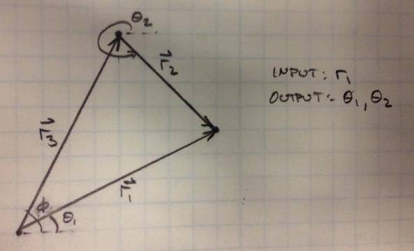

So if I've understood you right, then the attached picture would be the vector diagram I would draw (I called it θ1 instead of θ). Thus, the position analysis would be:
[itex]\vec{r_1}-\vec{r_2}-\vec{r_3}=0[/itex]
Using the method I described earlier:
[itex]r_1e^{j\theta_1}-r_2e^{j\theta_2}-r_3e^{j\phi}=0[/itex]
Separating the real and imaginary parts and substituting the known values:
[itex]r_1\cos{\theta_1}-L_1\cos{\theta_2}=L_2\cos{\phi}[/itex]
[itex]r_1\sin{\theta_1}-L_1\sin{\theta_2}=L_2\sin{\phi}[/itex]
The only things you don't know in these equations are θ1 and θ2, since you're providing a value for r1. With 2 equations and 2 unknowns, it's just math from here on out.

Yes the sketch you have drawn is spot on, I appreciate the time you have put in here.
The equations are the same (minus one sign which was wrong) as mine so I can atleast be sure I understand that part of the problem.
I think it is actually the solving of the two equations, with the trig, that I am getting stuck on.
