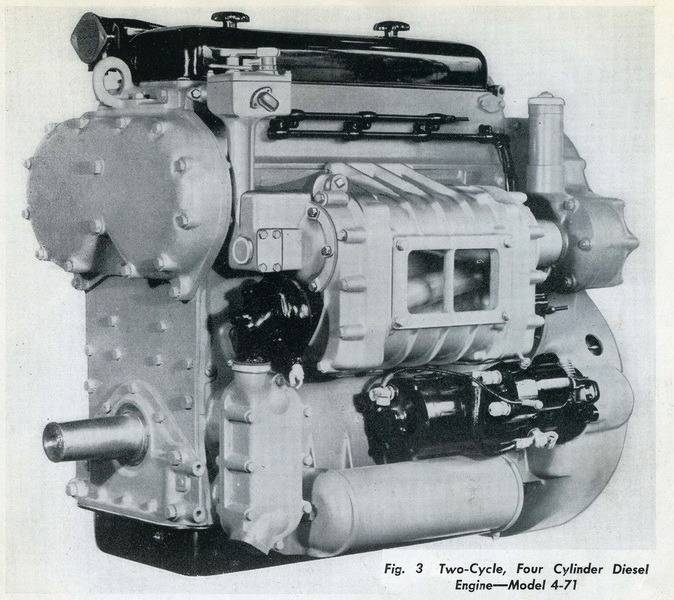

Now a supercharger could allow you to bypass the crankcase much like in a detroit diesel.
