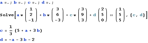

Solving a matrix equation Ax=b is, in effect, asking what linear combination of the columns of A will give b? One can solve the problem from that point of view with a solver as found in many modern mathematical software packages. For example, here is the solution given by Mathematica. We're asking, what values of a, b, c and d will provide linear combinations of the columns of A equal to b:
The solution is saying that we may pick a and b arbitrarily and then c and d will be determined as shown in the solution. Notice that we may pick integers a and b such that c and d will also be integers. There are your "nice" solutions. And, of course, we can see why there are an infinite number of solutions.
engineer_ja said:
Also, when solving, why do we get the "nice" numbers and not the row space part only?
Elimination methods, such as Gaussian elimination, or the Gauss-Jordan method don't just naturally give a solution that excludes a null space component. The solution is nice looking because you are starting with integer coefficients and doing rational arithmetic to obtain a solution.

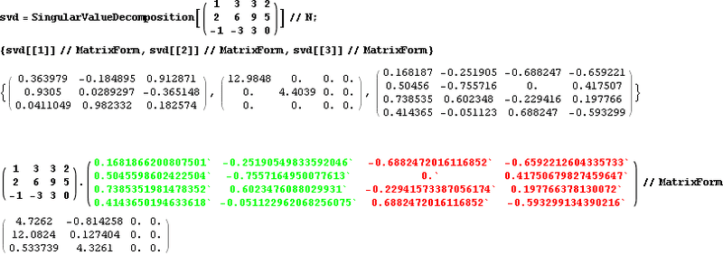

How do I find these two separate parts? Do I take a dot product with something...or solve more simultaneous equations...
To answer this question will, I suspect, go beyond the scope of the course you're taking.
My favorite way to do this is to use the singular value decomposition, which you will have to find out about elsewhere.
Your A matrix is not square; you have fewer equations than variables, so right away there is the possibility of an infinite number of solutions. Yours is a 3x4 A matrix, so the rank of the matrix (you may have to look up the word "rank") can't be greater than 3, but in fact the rank is only 2. This means that only 2 vectors are needed to span the row space and 2 more will span the null space.
Here is the singular value decomposition obtained with the help of Mathematica. The two (orthogonal) column vectors in green span the row space (providing a row space basis), and the two (orthogonal) red column vectors span the null space (providing a null space basis). You can see the result of the premultiplication by your A matrix; two non-zero columns (from the row space basis) and two zero columns (from the null space basis).
Given these basis vectors, you can decompose any solution into its component parts.
As I said, this is probably beyond the scope of your coursework, but if it piques your interest, good for you!
