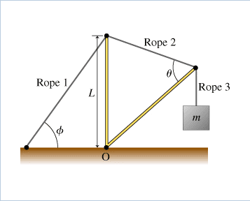

A quarry crane is used to lift massive rocks from a quarry pit. Consider the simplified model of such a crane shown in the figure. (Figure 1) The ends of two poles are anchored to the ground at the same point (point O). From this point, one pole rises vertically and the second pole rises at an angle. The vertical pole has its free end connected to the ground via an unstretchable, massless rope labeled rope 1. A second rope, labeled rope 2, connects the free ends of the two poles. The angle between the tilted pole and rope 2 is θ. Both poles have length L and can be considered massless for the purposes of this problem. Hanging from the end of the second pole, via rope 3, is a granite block of mass m.

τ1=F1*l1
τ2=F2*l2
τ3=F3*l3
Ʃτ1,2,3 = 0
Part A) Correct- T3 = mg
Part B) Correct- T2 = mgsin(∏-2θ)/sin(θ)
Part C) Incorrect -
I know that the torque of rope 1 on the vertical pole in relation to the origin is τ1=T1*L*cos(ϕ)
In my attempt I used the previously found values T2, and for l I used L*sin(2θ).
Combining these I found
τ2 = -Lmgsin(2θ)2/sin(θ) ;
setting Ʃτ = 0, so τ1 = τ2, solving for T1 yields
T1 = mg(sin(2θ))2/sin(θ)cos(ϕ);
Originally I had used the value of (∏-2θ) rather than 2θ, but since the problem is the only one that does not call for the quantity of ∏, I replaced it with 2θ. I've been told it's incorrect, and it is not a problem with signs. I think I may be having a problem finding the moment arm with my geometry for the torque of rope 2, or may just be combining the equations incorrectly. I assumed that T2 would be usable.
Any help would be very much appreciated.
p.s. This problem has been posted and discussed on various places online, however none of them seem to go into the third part of the problem to find T1.
I would have thought the horizontal component of T1 would simply have to match the horizontal component of T2
Check your trigonometry and mak sure to fuly simplify. You have the right equation, just remember, that when you divide sinθ^2/sinθ, you are left with just sinθ in the numerator. The correct,simplified, answer would be T1=[mgsin(2theta)] / cos(ϕ)
