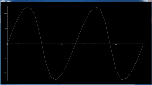

Hello,
In the following voltage vs time graph as we can see the voltage becomes negative often time.
My question is: if power= V*I then when voltage is negative do I have negative power?
When your voltage switches direction, your current would as well. So if V = +ve, then I = +ve and if V= -ve then I=-ve.
So either way P is always positive.
Ah true, didn't realize that. Thank You.

For a load that's not purely resistive, there'll be a period of time where your voltage and current is of opposite sign, which means whatever was consuming power before is now providing it. The power factor of your load is a measure of how "severe" this effect is.
The extra line loss associated with this return flow of power (reactive power) is one of the reasons why electric utilities won't provide you with power unless you bring your power factor up to code.
For pure resistance V and I are in phase so power is always positive and power is dissipated.
For pure inductance and pure capacitance V and I are out of phase by 90 degrees which means that power goes positive then negative and zero power is dissipated over one cycle.
these components are described as 'reactive' to distinguish them from 'resistive'
