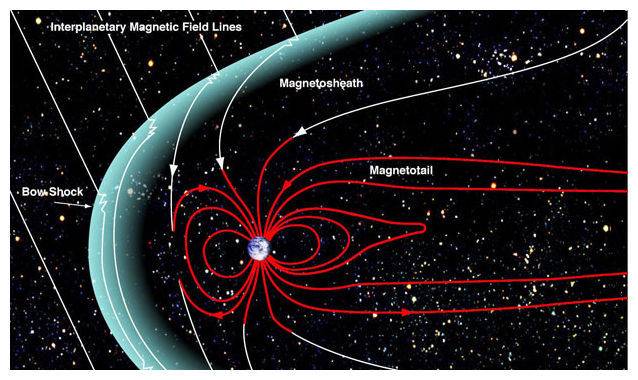

Hi magnetics
maybe you don't realize that the Earth's magnetic field surrounds the Earth and extends out into space 1000's of kilometres ?
At 10,000m or even 100,000m you are still deep within the field
The magneto tail stretches 100's of 1000's of km "down stream" of the Earth ( ie the opposite direction to the sun as seen in the above pic
do some googling on the Earth's magnetic field for tons of info and images :)Dave
