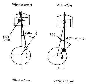

Lots of "tuners" prefer mechanical lifters, which can make an annoying racket. Personally, I'm willing to forgo the potential performance increase in order to avoid the hassles of spending half of my life under the hood with a wrench. Anti-pump-up hydraulic units for this boy...
Timing equipment, be it double-roller chains and sprockets or dual-idler gear drives, contributes to the overall under-hood ambience, as do the various accessory drive belts and pulleys for such things as the alternator and water pump. Even airflow through the radiator can be noisy. Piston slap can be annoying, and can be good or bad depending upon the reason. (My Roadrunner sounds like a coffee can full of rocks because the pistons are mounted backwards for increased efficiency. It only adds about 35hp, but that's still worth the auditory assault.) There are more factors, but that covers the most predominant ones.
Some of those things increase the power of the engine, and some rob from it, but the robbing ones are necessary for streetability.
edit: I made a somewhat misleading statement regarding the pistons. The decrease in frictional losses due to them being installed backwards accounts for about 35hp. Because of their design, though, doing so also kicks the compression ratio up from 12 to 12.5. That's worth even more.
