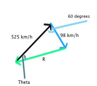

A plane is steering N45°E with an airspeed of 525 km/h. The wind is from N60°W at 98 km/h. Find the ground speed and the direction of the plane.
Cosine law, sine law, vector addition/subtraction.
I have attached an image of my diagram (sorry for the messiness!)
I Solved for R using the cosine law:
R^2 = 525^2 + 98^2 - 2(525)(98)cos60°
R^2 = 285229 - 102900cos60
R^2 = 233779
R = 483.5 km/h
As for the angle, theta, I also used the cosine law:
98^2 = 525^2 + 483.5^2 = 2(525)(483.5)cosθ
-499793.25 = -507675cosθ
cosθ = 0.9844
θ = 10.1°
Is my method correct?
Thank you in advance!

The wind is from N60°W ...
That means the angle you label as 60° should be 60° + 45°.

Thank you for the reply.
Okay, so using 60° + 45°, I calculated my new resultant vector as 558.4 km/hr.
The only issue is when I solve for theta, cosθ = 1.138, which cannot be solved for.
Is there something I'm missing?

What is the equation you have when solving for cos(θ)?

Oh! I'm sorry, I just realized my mistake (substituted the wrong value) :)
Anyways, my new θ turns out to be:
98^2 = 525^2 + 558.4^2 - 2(525)(558.4)cosθ
-577831.5 = -586320cosθ
cosθ = 0.9855
θ = 9.8°
Hopefully my method is correct?

Yup. I got 9.759° .
