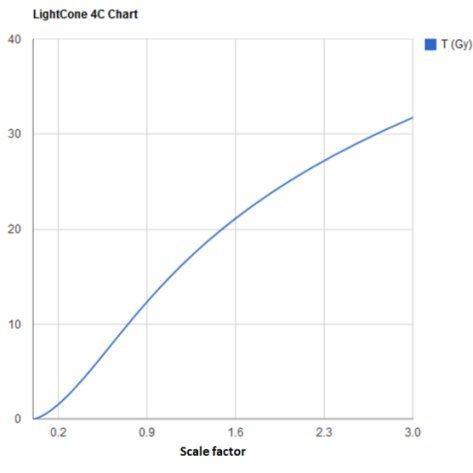

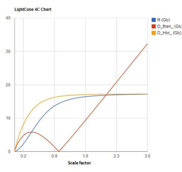

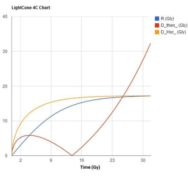

Visualization of the choice
I have added a quick and dirty Google Chart option to an experimental version of the Lightcone 4 calculator. Below are two charts that give some visualization of the choices (scale factor and time) for identical parameters and input range. The red graphs represent our past and future light cones.
[Edit] And to visually explain the similar, but different shapes, here is time vs. expansion over the same range, showing the two inflections.
[/Edit]
The Chart option still requires some refinement, but it should later become a standard option. It will require an internet connection to operate, since data are passed to Google Charts and it returns the graphic to the browser.
-J

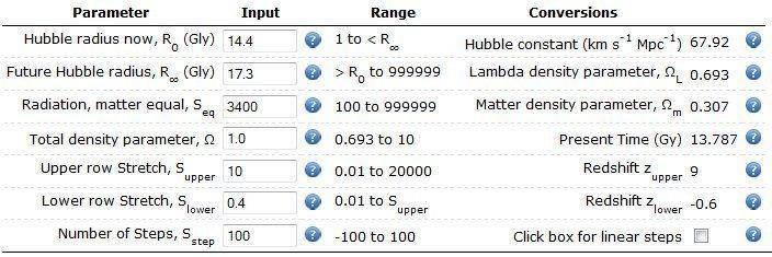

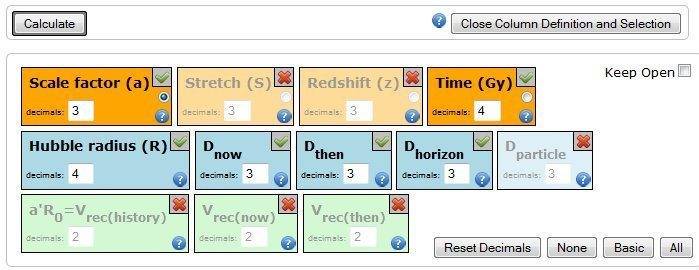

Some refinements have been implemented and LightCone 6 is now available for "production" use. The chart option requires some tinkering in order to produce useful graphs - the y-scale depends on the max values in the columns selected, so some columns will mask others due to their magnitudes. There are two remedies: select columns that have similar ranges, or select an S-range that does not produce wildly different magnitudes in the columns selected for the graph.
Note the radio buttons inside the top row of selection blocks - they are used to select one of those columns as the horizontal axis of the graphs. The default at start-up is Scale factor.
To post a graph to the forum, use your usual browser controls to save the image as [any name] and then upload it to the forum.
In the input section, note the 'Total density parameter, Ω' on the left side. You can now play around with a curved spatial geometry. :-)
Mordred and myself will update the user guide as time allows. It now resides in a http://cosmocalc.wikidot.com/tabcosmouserguide.
Please let us know of usability issues or bugs.
PS: The graph generation does not actually run on Google's servers (as I said in prior post); it loads some temporary javascript code to your browser (just like the calculator itself) and then executes the charting locally. The only info sent from your computer is the upload of the image to the forum (as is your reply...)
