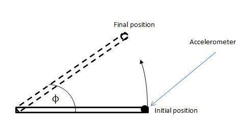

I am working on a project where we will use a 3-axis accelerometer on the door and using the ax, ay, az data to calculate position and angle of the door. The accelerometer will be positioned near doorhandle. So the initial position of coordinate system will be there, where the accelerometer is.
While the door will be opening the position of coordinate system will be moving(rotating).
Need help with calculating the position and after that the angle of the door. Especially I don't know how to take into account that we have rotating coordinate system. It seems a tough problem...

Your accelerometer is attached to the door - so that's your coordinates.
If you put x horizontal, y vertical, and z pointing away from the door, then any instantaneous acceleration in the z direction will be tangential to path the door makes - then you can predict which axis there will be reading in for the accelerometer.
You need to use your knowledge of rotational motion for this.
If the door opens with a constant angular velocity, which direction is it accelerating?
However, the door will have some angular acceleration too - can you relate angular and tangential acceleration and velocity?
That should get you started.

I prefer the natural system of axis orientation, so x is horizontal, y is away from the door and z vertical. So, the y-axis will be tangential to path the door makes. In this way also door is accelerating in y direction.
And yes, tangential acceleration is a product radius and angular acceleration. I know physics, I just need help with math...

The y-axis acceleration readings will be the tangential acceleration.
How would you measure the radius to use to get the angular acceleration?
Is the y-axis the only direction you should see an acceleration?
Basically we get data from accelerometer, which means ax, ay and az. So if I set the coordinate system as I have described above, this means that ax=w2R(w-angular velocity, R-radius) will be radial acceleration, ay=aR(a-angular acceleration) will be tangential acceleration and az will measure gravitational acceleration-g. Correct me, if I am wrong. From ay I can calculate angular acceleration, from ax angular velocity and from there probably the angle the door makes? Radius is fixed and determined by the door size.
Using centripetal acceleration (ax = ω2r) to compute angular velocity will, I suspect, tend to run into problems with resolution at low accelerations. Since centripetal acceleration scales as the square of angular velocity, a small velocity will be reflected as a very small acceleration.
Then too, you can only measure the door's angular speed, not velocity, based on centripetal acceleration. Opening and closing look the same.
You could integrate angular acceleration to get angular velocity instead. But then you hit the opposite problem. If the door slams you get very high and very sudden accelerations for modest velocities. Your equipment may not be able to register that accurately.
And you also have the problem that small systematic errors grow quadratically over time.
Possibly you want to apply some to sanity-checking to the measurements that you obtain -- cross-checking the speed figures estimated from centripetal acceleration against the velocity figures dead-reckoned from angular acceleration.
Possibly you want to figure out some heuristics to detect slamming events and coast-to-a-stop events.

Now you are cooking :)
You know the equations for all those right?
Then you have all the math you need.

The area under the a-t graph is the velocity.
The area under the v-t is the displacement.
... again, software typically supplied is capable of computing these graphs from the data.
If not, then you will have to tell it how - hint: numerical integration.
Careful with centripetal acceleration.
Since the radius is fixed, what is wrong with using the tangential acceleration to get velocity and position?

Thnx to both, Simon Bridge and jbriggs444! I am aware of the problems you have mentioned, but we will try and we see what comes out. There is another challenge. What if the z axis is not exactly in the direction towards the center of the Earth and also the x-axis not exactly towards the origin of rotation etc. Then probably I will have to apply rotation matrix 3 times, to calculate the exact values of ax, ay and az? What do you think about it?
Also, the accelerometer has the sampling rate of about 250 Hz... and it's accuracy is 5 %, at least that's what they say...
If the alignment of the accelerometer is off by a bit, that seems like a simple thing to deal with -- at least as long as the door behaves ideally.
All you need to do is rotate your as-measured acceleration readings in the accelerometer frame to ax, ay and az readings in the door frame. As long as the angle between accelerometer and door is fixed, that's a fixed 3x3 rotation matrix applied to the input 3-vector to produce the output 3-vector.
An accuracy of five percent... I'm not sure what to make of that. Sounds hideous. Which suggests that you have some calibration work to do. You need to figure out just how far you can trust your tools.
A 5% accuracy is pretty bad for an accelerometer - it sounds like the sort of thing you get in a phone in fact [1][2] - but it means you probably don't have to be very accurate in setting it up. What level are you performing this experiment at? (It sounds like a HS exercise in rotational motion - but it could be part of a senior undergrad project in electronic and computational engineering.)
You can probably get away with using a spirit level and a set-square to set the alignment - you may want to tape a protractor to the door (use with a plumb-line) to see that it opens horizontally.
Note: it will probably be helpful to get something to read the position vs time directly.
Integrating the acceleration-time graph (once for velocity and twice for position) leads to very large errors.[3]
