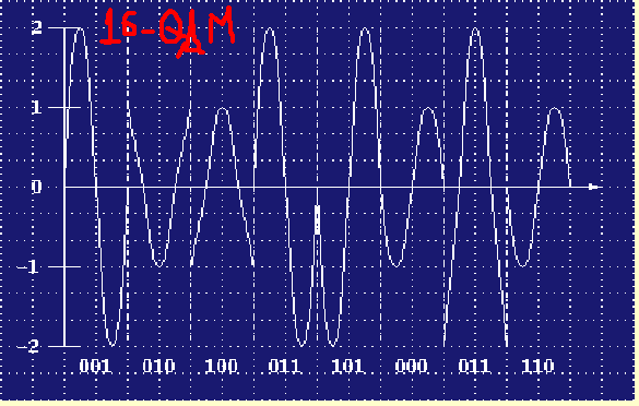

At the output of my DSP i have a 16-QAM analog signal fc=10KHz and BW=20KHz like this one: http://i1284.photobucket.com/albums/...pse9ee0bf9.png
I have one output port at DSP.
So i can use a 90 degree splitter to create the same 16QAM like above but with 90 degree shift? So i will have I and Q signals
And then use a I/Q modulator to upconvert this one with carrier 100MHz?

The DSP at this time has one port output. The output is an analog signal like this:
[/URL]
My DSP output is already a 16QAM analog modulated signal. I want just to upconvert it at 20 MHz with one I and Q modulator SSB-SC.
OK, so all you really want is to configure the IQ modulator as a single sideband modulator :)
In that case, it should work.
However, note that in order to get could surpression of the unwanted sideband you might need to adjust the phase a bit; 90 degrees is for an ideal mixer and in real life the phase that gives the best surpression might be a bit different. That said, you would need a spectrum analyzer to check this and if you don't have one 90 degress will be better than nothing.
Yes exactly IQ Modulator as a SSB Modulator. Maybe so, i need tunable degrees shifter. (i don't know if exists).
