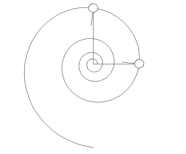

When the radius of the circle decrease the object moves faster(With the same force)
I believe this is a misconception .In common sense the object revolves around more,This leads us to think that it is moving fast but actually the object moves the same distance.Am I right?
This is wrong, if "the same force" refers to centripetal (or centrifugal) force. Check its formula to see it.
If you pull a circling object towards the center, it will increase its velocity (and increase the required force for a circular orbit a lot).
If you have something else in mind, please explain it.
During the time that the object is pulled inwards, a portion of the force is in the direction of the path of the object, which increases the speed of the object. Angular momentum is conserved. The work done on the object = the tension (as a function of radius) x change in radius, which equals the increase in KE (1/2 m v^2) of the object. Angular momentum is conserved. For example, if the radius is reduced to 1/2 the original radius, the speed is doubled and the tension increased by a factor of 8. This image is an example, the short inward lines are perpendicular to the path, while the long lines are in the direction of the inwards force:

It's surprisingly to difficult to reduce the radius while keeping the centripetal force constant; rcgldr's post explains why. Note especially his comment about conservation of angular momentum; if angular momentum is conserved the centripetal force will be greater after the radius is reduced.
Counterintuitvely, if you consider the centripetal force equation with F and m constant
[tex]F=\frac{mv^2}{r} \Rightarrow v \propto \sqrt{r}[/tex]
the speed decreases with the radius - but the only way you can make that happen is to apply some external action to reduce the angular momentum and the kinetic energy of the system.

adjacent said:
how does the speed change?
I answered that in my previous post. During the transtion where the radius is decreased, the path of the object is no longer a circle. In the image I posted above, I use a spiral like path. During this transition when the path is not circular, a component of the force is in the same direction as the path of the object, changing it's speed. The speed is increased if the radius is decreased, and the speed is decreased if the radius is increased.
The path doesn't have to be a spiral. You could adjust the radius inwards and outwards periodically so that the path is an ellipse. The objects speed would be fastest when the radius was smallest and slowest when the raidus was largest. Again it's the component of force in the direction of the path of the object that is causing it's speed to change. Using the fact that angular momentum is conserved makes it easier to calculate the speeds (versus using calculus to determing the force versus object speed versus radius to use the force to determine acceleration in the direction of the object and change in speed).
