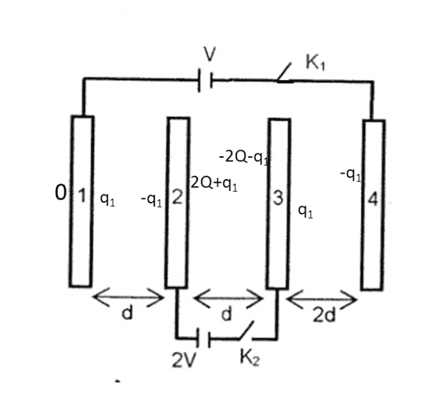

The charge on the left face of plate 1 and right face of plate 4 is zero from the result of previous solution. The new charge distribution is shown in the following figure.
Looks good?
Right, that's the new charge distribution. So what's the potential difference (in terms of the Qs and ds) between plates 1 and 4?
[tex]\frac{q_1}{C}+\frac{2Q+q_1}{C}+\frac{q_1}{C/2}=V[/tex]
where ##C=A\epsilon_o/d##
Looks correct?

I do get option B) as my answer. Solving the above equation,
[tex]q_1=\frac{CV}{4}-\frac{Q}{2}[/tex]
We require the charge on the right surface of plate 2 which is ##2Q+q_1##. Substituting ##q_1##, I get B.

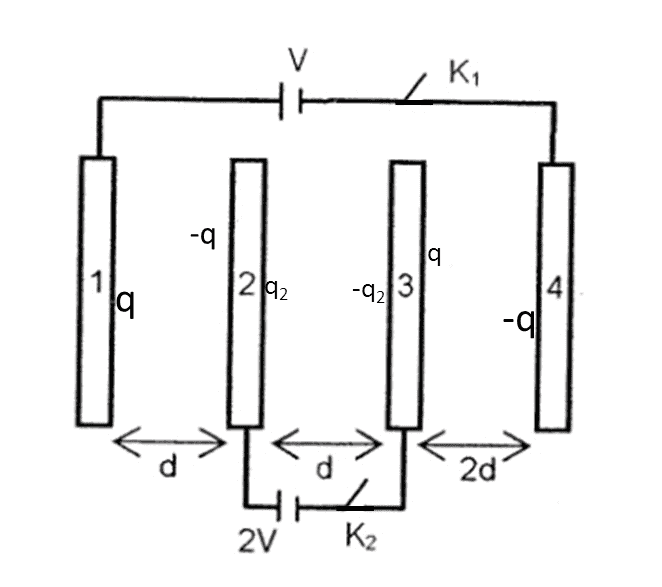

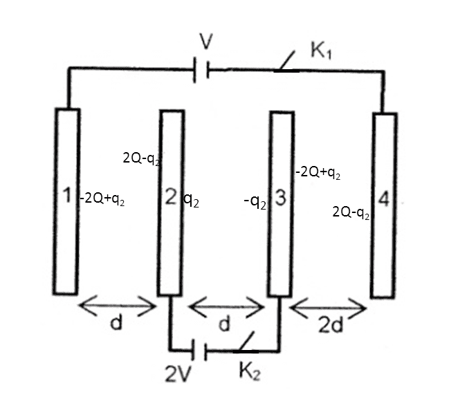

Here's how I think the charges arrange,
Correct?
With both switches closed, Q cannot matter any more. The charges will rebalance between 1 and 4 and between 2 and 3 in a way that's entirely driven by the applied potentials. Your diagram shows the total charge on plate 2 being 2Q, so I don't think it can be right.
You do know that plates 1 and 4 will have opposite total charges, and plates 2 and 3 will have opposite total charges. Try assigning unknowns to those and solving.
How about this one:
Yes, that looks right. Now deduce the relationship between q and q2 from the potential differences.
I get
[tex]V-\frac{q}{C}-2V-\frac{q}{C/2}=0[/tex]
Solving this,
[tex]q=\frac{-CV}{3}[/tex]
Hence, the charge on plate 4 is -q=CV/4.
Thank you, haruspex! :smile:
