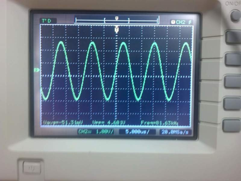

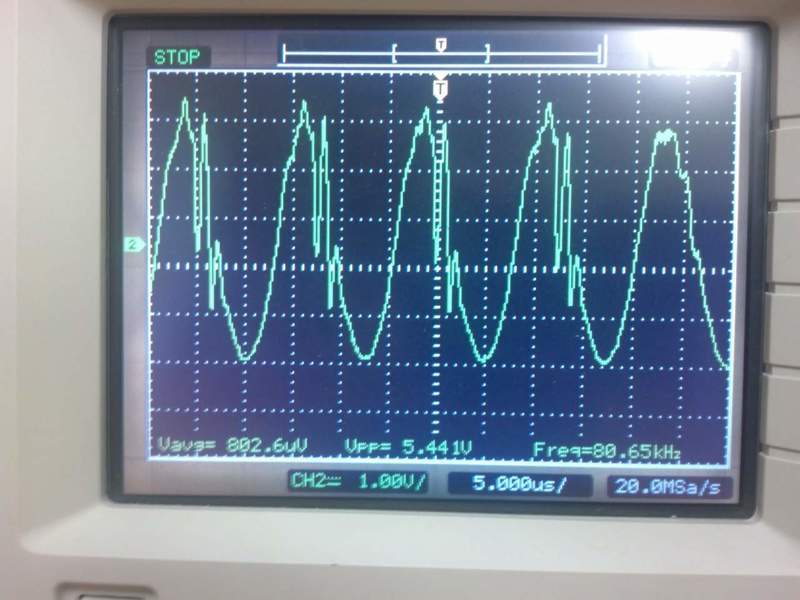

These are some oscilloscope readouts using the AD826 and the circuit I showed previously (plus the 3 pF feedback resistors). The first is with 4 stages. The second is with 5 stages. All are exact copies of one another. Adding the 5th stage causes some major issues as you can see. This problem did not occur with the LF353s.
I should also mention that the problem occurs with less stages if the gain on each stage is increased (regardless of input voltage). For example, if I were to change the sense resistor value to 100 Ω instead of 220, I would expect to see similar distortion appear at an earlier stage.
