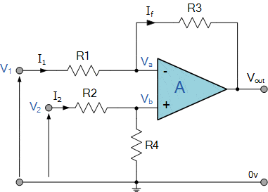

I've been trying to figure out why my DC subtraction amplifier is not working, and am completely baffled. I have set up an op amp with no feedback resistors with voltages applied to both the inverting and non-inverting inputs as specified below. I previously had the op amp setup with a 10x gain differential op amp following this circuit and obtained similar results. I tried searching and attempting the calculations for the op amp, and reading up on them in a couple books I had but I can find no explanation as to why this would not work. I used values of 5v, and 1v so that it would not be operating near the rail, and should have a gain of 1 since no resistors are added.
The Op amp output voltage should be Vo = Av*V1-V2 where V1 is the noninverting, and V2 is the inverting inputs. Av (Voltage Gain) = 1; therefore 5v-1v = 4 Vout is expected.
Op Amp: TL072CP & LM358
Supply Voltage +10v (Single Supply)
Inverting Input Voltage Applied: 1v DC
Non-Inverting Input Voltage Applied: 5v DC
Output Voltage Measured: 9.6V DC for TL072CP, 8.9v for LM358
You say you have set up the circuit with no feedback resistors yet the schematic shows it. Are all resistor of the same value?
I have answered my own question after further research. Removing the resistors gives an ideal op amp infinite voltage gain operating "Open Loop".
The LM358 for example has approximately 100dB of gain which is 10^5*(V2-V1) since the op-amp responds only to the difference signal (V2-V1) where V2 = Non-Inverting input voltage, and V1 = Inverting input voltage and hence ignores any signal common to both inputs (Common mode rejection)
If I only vary the V2-V1 by 5mV (1v-0.995v) output will be 0.005*10^5 = 500v [(V2-V1)*Gain] and since the rails are 10v it will be saturated and given that the LM358 is 1 diode drop + a little below Vin that accounts for why I was getting between 9.6v and 8.9v the op amps saturation point.
I simply replaced the resistors with all 1k giving me 1x gain, and now am getting the expected result.

An operational amplifier "operates" by forcing its inputs equal.
It is the job of the circuit designer to surround the amplifier with a circuit that allows it to do that.
Else it cannot "operate".
easy to remember 3 step method to evaluate an opamp circuit
1. write KVL for voltage at noninverting input.
2. write KVL for voltage at inverting input.
3. Set 1 equal to to 2 and solve for Vout

By my simple old man's method , the opamp 'operates' by forcing its inputs equal
if all 4 resistors are equal,
Va = (V1 + Vout )/2
Vb = V2/2
equating Va and Vb gives
V2/2 = (V1 + Vout )/2
multiply both sides by 2
V2 = V1 + Vout
Vout = V2 - V1
with Va and Vb both V2/2

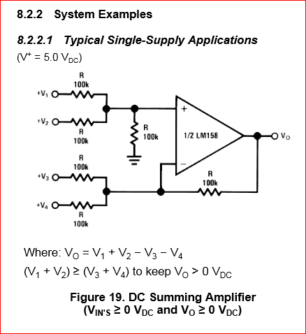

Weelll,
if it's a TI LM358, http://www.ti.com/lit/ds/symlink/lm158-n.pdf
it ought to be capable of single supply differencing

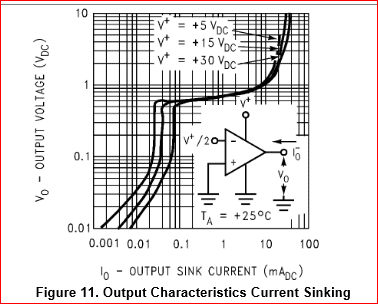

1k is too low for his feedback resistor R3 because of its output sinking capacity
hence the 100k in TI's datasheet application circuit
but as you say it'd work fine with split supply.
